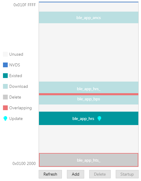

GProgrammer graphically displays the flash memory space layout occupied by firmware (see Figure 12), which helps you easily learn the flash occupation status.
represents flash space to which data can be downloaded.
represents default NVDS area to which firmware cannot be downloaded.
indicates space for storing to-be-deleted firmware. Example: ble_app_hts_.
indicates space for storing to-be-downloaded firmware. Example: ble_app_ancs.
indicates space for storing downloaded firmware in flash memories. Example: ble_app_hrs.
indicates space overlapped by two pieces of firmware. Examples: ble_app_hrs_ and ble_app_bps.
