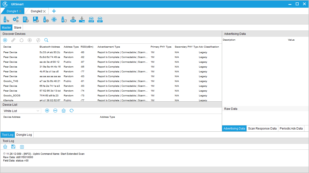

Figure 1 shows the Graphical User Interface (GUI) of GRSmart.
