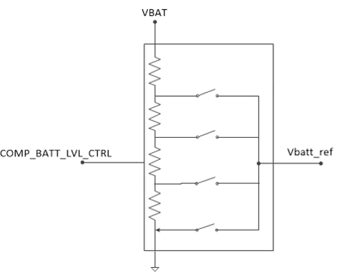

Once enabled by configuring the COMP_REG_0.WAKE_COMP_EN bit, the comparator starts to work. When the wakeup comparator module is started, V1 starts to be compared with V2 continuously. When V1 exceeds V2, the wakeup comparator will be triggered. The CHANNEL_SEL_P and CHANNEL_SEL_N fields are used to select the input of V1 and V2. When Vbatt_ref is selected in the CHANNEL_SEL_N or CHANNEL_SEL_P field. The COMP_BATT_LVL_CTRL field is used to select a level value. The following figure shows the settings of VBAT control level. The COMP_BATT_LVL_CTRL level value ranges from 0 to 7, and the calculation formula of Vbatt_ref is shown below:
Figure 86 Set of VBATT control level

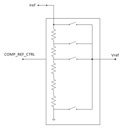

When Vref is selected in the CHANNEL_SEL_P or CHANNEL_SEL_N field. The COMP_REF_CTR field is used to select a level value. The settings of Vref control level is showed in the following figure. The COMP_REF_CTRL level value ranges from 0 to 255, and the calculation formula of Vref is shown below:
When the Vref voltage is within the range of 30 mV to 1.7 V, the actual output voltage of the Vref can closely approximate the calculated value derived from the formula above.
Figure 87 Set of Vref control level
