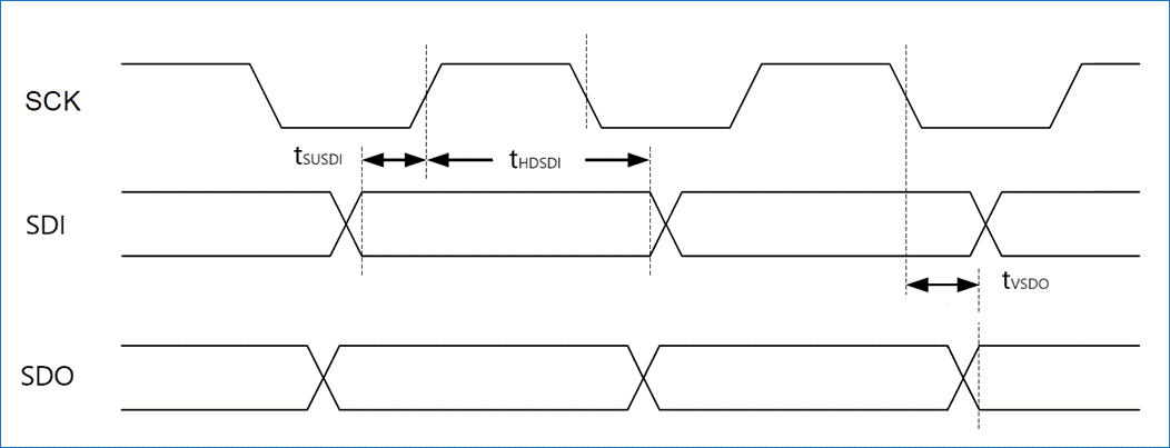

Electrical Specifications
表 239 Electrical Specifications
Symbol Description Min. Typ. Max. Unit
fSCK
I2S clock frequency
3072
kHz
tSUSDI
Data input setup time (from SDI to SCK)
20
ns
tHDSDI
Data input hold time (from SCK to SDI change)
15
ns
tVSDO
Data output valid time (from SCK to SDO valid)
20
ns
DCSCK
SCK Clock duty cycle
45
55
The I2S Timing Diagram is in 图 47:
图 47 I2S Timing Diagram
