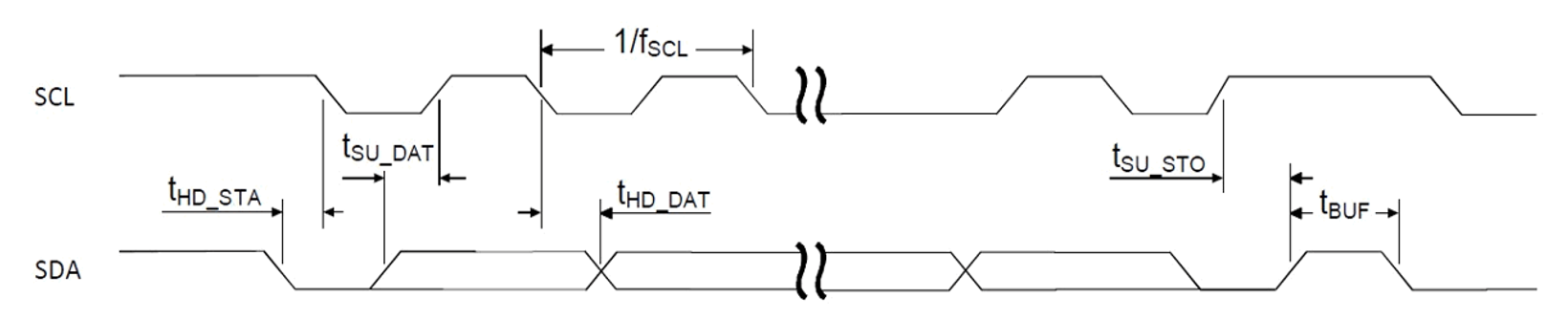

Electrical Specifications
Symbol | Parameter | Standard Mode(SS) | Fast Mode (FS) | Fast-plus Mode (FM+) | High-speed Mode (HS) | Unit | ||||
Min. | Max. | Min. | Max. | Min. | Max. | Min. | Max. | |||
fSCL | SCL clock frequency | 0 | 100 | 0 | 400 | 0 | 1000 | 0 | 2000 | kHz |
tLOW | SCL clock LOW time | 4.7 | - | 1.3 | - | 0.5 | - | 0.16 | - | μs |
tHIGH | SCL clock HIGH time | 4.0 | - | 0.6 | - | 0.26 | - | 0.06 | - | μs |
tRSDA | SDA rise time | - | 1000 | 20 | 300 | - | 120 | 10 | 80 | ns |
tFSDA | SDA fall time | - | 300 | 300 | 120 | 10 | 80 | ns | ||
tRSCL | SCL rise time | - | 1000 | 20 | 300 | - | 120 | 10 | 40 | ns |
tFSCL | SCL fall time | - | 300 | 300 | 120 | 10 | 40 | ns | ||
tHD_STA | START hold time | 4.0 | - | 0.6 | - | 0.26 | - | 0.16 | - | μs |
tSU_DAT | SDA setup time | 250 | - | 100 | - | 50 | - | 10 | - | ns |
tHD_DAT | SDA hold time | 0 | - | - | - | - | - | 0 | 70 | μs |
tSU_STO | STOP setup time | 4.0 | - | 0.6 | - | 0.26 | - | 0.16 | - | μs |
tBUF | BUS FREE time from STOP to START | 4.7 | - | 1.3 | - | 0.5 | - | - | - | μs |
Note:
The bus load capacitance Cb = 100 pF.
