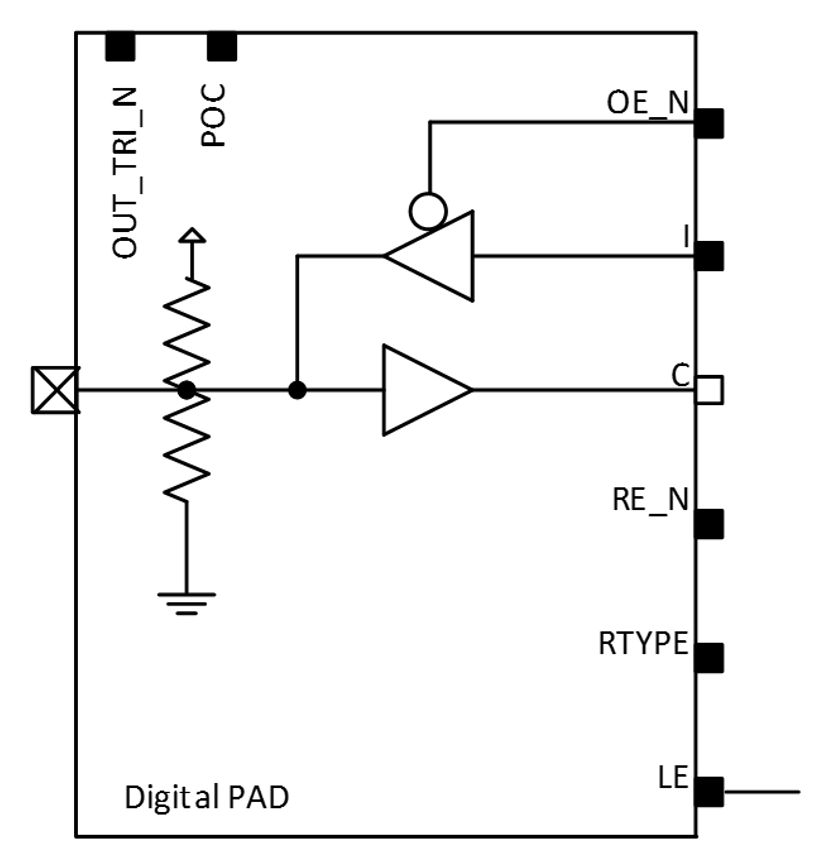

A functional drawing of the GPIO pad is shown in 图 19. The digital GPIO pads can be configured to set direction, enable pull-up/pull-down resistors and enable output retention.
图 19 GPIO pad diagram
