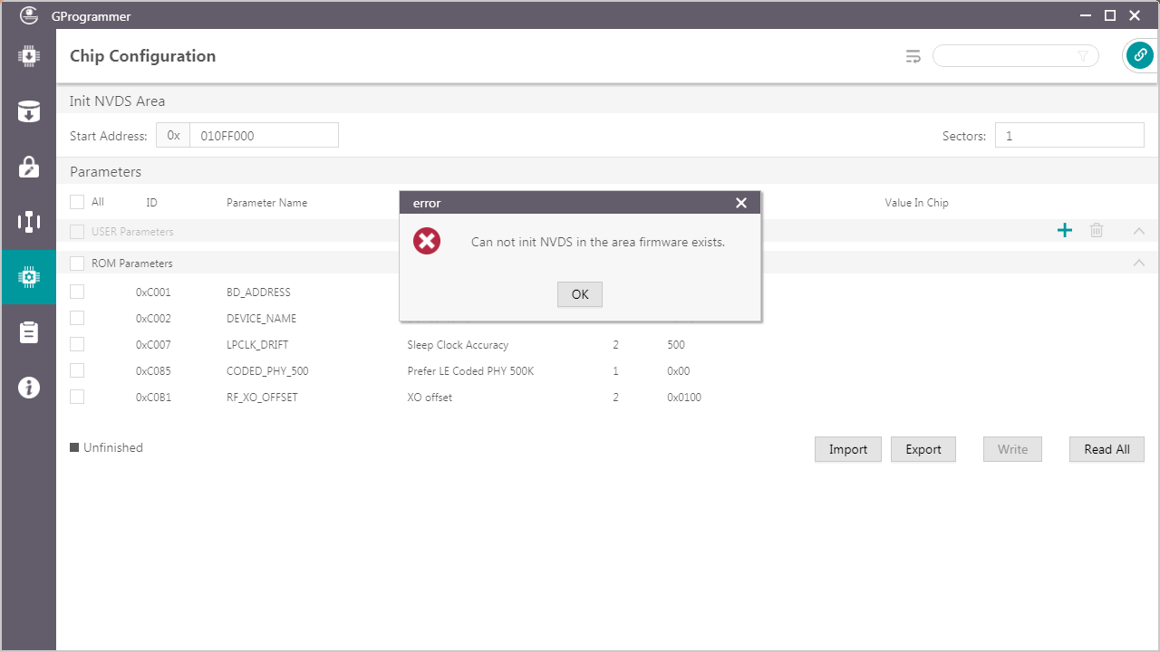

Init NVDS Area
Prior to configuring NVDS parameters, users need to specify a starting address (4 KB aligned) and the number of occupied sectors in the NVDS area.
NVDS initialization fails when the configured NVDS area overlaps with the existing firmware area.
