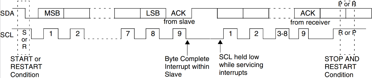

The I2C is a synchronous serial interface. The SDA line is a bidirectional signal and changes only when the SCL line is low, except for STOP, START, and RESTART conditions. The output drivers are open-drain or open-collector to perform wired-AND functions on the bus. The maximum number of devices on the bus is limited by only the maximum capacitance specification of 400 pF. Data is transmitted in byte packages.
The master is responsible for generating the clock and controlling the transfer of data. The slave is responsible for either transmitting or receiving data to/from the master. The acknowledgement of data is sent by the device that is receiving data, which can be either a master or a slave. The I2C protocol also allows multiple masters to reside on the I2C bus and uses an arbitration procedure to determine the bus ownership.
When a master wants to communicate with a slave, the master transmits a START/RESTART condition that is then followed by the slave address and a control bit (
) to determine if the master wants to transmit data to or receive data from the slave. The slave then sends an acknowledge (ACK) pulse after the address.
If the master (master-transmitter) is writing to the slave (slave-receiver), the receiver gets one byte of data. This transaction continues until the master terminates the transmission with a STOP condition. If the master is reading from a slave (master-receiver), the slave transmits (slave-transmitter) a byte of data to the master, and the master then acknowledges the transaction with the ACK pulse. This transaction continues until the master terminates the transmission by not acknowledging (NACK) the transaction after the last byte is received, and then the master issues a STOP condition or addresses another slave after issuing a RESTART condition. This behavior is illustrated in Figure 60.

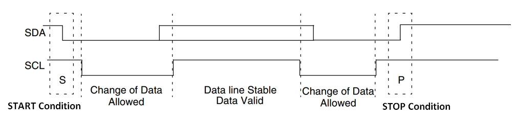

START and STOP Conditions
When I2C operates as a master (writing 1 to CTRL[0], and writing 1 to CTRL[6]), putting data into the transmit FIFO causes the I2C block to generate a START condition on the I2C bus. Writing 1 to DATA_CMD[9] causes the I2C block to generate a STOP condition on the I2C bus; a STOP condition is not issued if this bit is not set, even if the transmit FIFO is empty. This behavior is illustrated as follows.
When operating as a slave (writing 0 to CTRL[0], and writing 0 to CTRL[6]), I2C block does not generate START and STOP conditions, as per the protocol. However, if a read request is made to the I2C block, it holds the SCL line low until read data has been supplied to it. This stalls the I2C bus until read data is provided to the slave I2C block, or the I2C block slave is disabled by writing 0 to I2C ENABLE Register (EN[0]). When the bus is idle, both the SCL and SDA signals are pulled high through external pull-up resistors on the bus. When a master wants to start a transmission on the bus, the master issues a START condition. This is defined as a high-to-low transition of the SDA signal while SCL is high. When a master wants to terminate the transmission, the master issues a STOP condition. This is defined as a low-to-high transition of the SDA line while SCL is high. Figure 62 shows the timing of the START and STOP conditions. When data is being transmitted on the bus, the SDA line must be stable when the SCL is high.

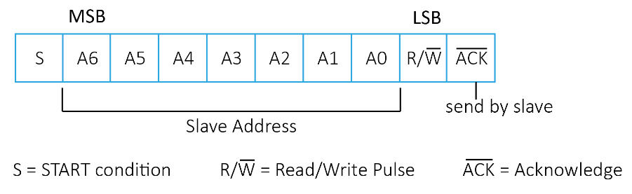

7-bit Address Format
Using the 7-bit address format, users should write 0 to CTRL[3] and the slave address is stored at I2C Slave Address Register (S_ADDR[6:0]). The first seven bits (bits 7:1) of the first byte set the slave address and the least significant bit (bit 0) (LSB) is the R/W bit as shown in Figure 63. When bit 0 (
) is set to 0, the master writes to the slave. When bit 0 (
) is set to 1, the master reads from the slave.

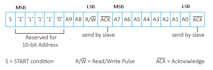

10-bit Address Format
Using the 10-bit address format, users should write 1 to CTRL[3] and the slave address is stored at I2C Slave Address Register (S_ADDR[9:0]). Two bytes are transferred to set the 10-bit address. The transfer of the first byte contains the following bit definition. The first five bits (bits 7:3) notify the slave that this is a 10-bit transfer followed by the next two bits (bits 2:1), which set the slave address (bits 9:8), and the LSB bit (bit 0) is the
bit. The second byte transferred sets bits 7:0 of the slave address.
Figure 64 shows the 10-bit address format.

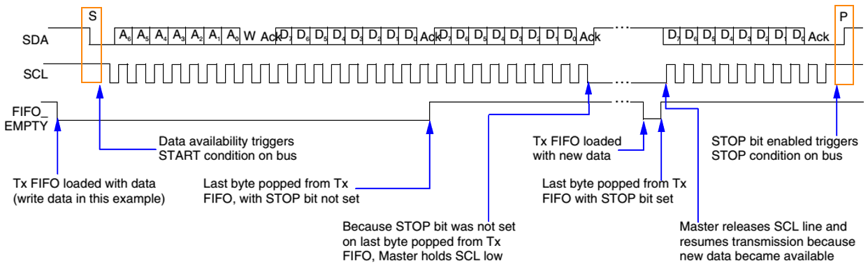

Master-Transmitter and Slave-Receiver
All data is transmitted in byte format, with no limit on the number of bytes transferred per data transfer. After the master sends the address and
bit or the master transmits a byte of data to the slave, the slave-receiver must respond with the ACK signal. When a slave-receiver does not respond with an ACK pulse, the master aborts the transfer by issuing a STOP condition. The slave must leave the SDA line high so that the master can abort the transfer.
If the master-transmitter is transmitting data as shown in Figure 65, the slave-receiver responds to the master-transmitter with an ACK pulse after every data byte is received.

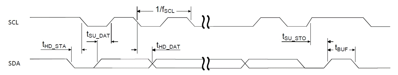

SDA Hold Time
The I2C protocol specification requires 300 ns of hold time on the SDA signal (tHD_DAT, SDA hold time, see Figure 71 in standard mode and fast mode, and a hold time long enough to bridge the undefined part between logic 1 and logic 0 of the falling edge of SCL in high speed mode and fast mode plus.
Board delays on the SCL and SDA signals can mean that the hold-time requirement is met at the I2C master, but not at the I2C slave (or vice versa). As each application encounters differing board delays, the I2C block contains a software programmable register (SDA_HOLD) to enable dynamic adjustment of the SDA hold time.
SDA_HOLD[15:0] are used to control the hold time of SDA during transmit in both slave and master mode (After SCL goes from HIGH to LOW).
SDA_HOLD[23:16] are used to extend the SDA transition (if any) whenever SCL is HIGH in the receiver (in either master or slave mode).
If different SDA hold times are required for different speed modes, the SDA_HOLD register must be reprogrammed when the speed mode is being changed. The SDA_HOLD register can be programmed only when the DW_apb_i2c is disabled (EN[0] = 0).

DATA_CMD
- Name: I2C RX/TX Data Buffer and Command Register
- Description: This is the register the CPU writes to when filling the TX FIFO and the CPU reads from when retrieving bytes from RX FIFO.
In order to continue acknowledging reads, a read command should be written for every byte that is to be received; otherwise the I2C will stop acknowledging.
- Base Address: 0x4000C300 + x*0x100
- Offset: 0x10
- Reset Value: 0x00000000
| 31:11 |
RSVD |
R |
Reserved bits |
| 10 | RESTART | W | 0x0 | This bit controls whether a RESTART is issued before the byte is sent or received. Value:
| 9 | STOP | W | 0x0 | This bit controls whether a STOP is issued after the byte is sent or received. Value:
| 8 |
CMD |
W |
0x0 |
This bit controls whether a read or a write is performed. This bit does not control the direction when the I2C acts as a slave. It controls only the direction when it acts as a master. Value:
| 7:0 |
DATA |
RW |
0x0 |
This register contains the data to be transmitted or received on the I2C bus. If you are writing to this register and want to perform a read, bits 7:0 (DATA) are ignored by the I2C. However, when you read this register, these bits return the value of data received on the I2C interface. |
SS_CLK_HCNT
- Name: Standard Speed I2C Clock SCL High Count Register
- Description: Standard Speed I2C Clock SCL High Count Register
- Offset: 0x14
- Reset Value: 0x00000190
31:16 |
RSVD |
R |
Reserved bits |
15:0 |
COUNT |
RW |
0x0190 |
This register must be set before any I2C bus transaction can take place to ensure proper I/O timing. This register can be written only when the I2C interface is disabled which corresponds to the EN[0] register being set to 0. Writes at other times have no effect. The minimum valid value is 6; hardware prevents values less than this being written, and if attempted, the value will be set to 6. Note: This register must not be programmed to a value higher than 65525, because I2C uses a 16-bit counter to flag an I2C bus idle condition when this counter reaches a value of COUNT + 10. |
SS_CLK_LCNT
- Name: Standard Speed I2C Clock SCL Low Count Register
- Description: Standard Speed I2C Clock SCL Low Count Register
- Offset: 0x18
- Reset Value: 0x000001D6
31:16 |
RSVD |
R |
Reserved bits |
15:0 |
COUNT |
RW |
0x01D6 |
This register must be set before any I2C bus transaction can take place to ensure proper I/O timing. This register can be written only when the I2C interface is disabled which corresponds to the EN[0] register being set to 0. Writes at other times have no effect. The minimum valid value is 8; hardware prevents values less than this being written, and if attempted, the value will be set to 8. |
FS_CLK_HCNT
- Name: Fast Mode or Fast Mode Plus I2C Clock SCL High Count Register
- Description: Fast Mode or Fast Mode Plus I2C Clock SCL High Count Register
- Offset: 0x1C
- Reset Value: 0x0000003C
31:16 |
RSVD |
R |
Reserved bits |
15:0 |
COUNT |
RW |
0x003C |
This register must be set before any I2C bus transaction can take place to ensure proper I/O timing. This register can be written only when the I2C interface is disabled, which corresponds to the EN[0] register being set to 0. Writes at other times have no effect. The minimum valid value is 6; hardware prevents values less than this being written, and if attempted, the value will be set to 6. |
FS_CLK_LCNT
- Name: Fast Mode or Fast Mode Plus I2C Clock SCL Low Count Register
- Description: Fast Mode or Fast Mode Plus I2C Clock SCL Low Count Register
- Offset: 0x20
- Reset Value: 0x00000082
31:16 |
RSVD |
R |
Reserved bits |
15:0 |
COUNT |
RW |
0x0082 |
This register must be set before any I2C bus transaction can take place to ensure proper I/O timing. This register can be written only when the I2C interface is disabled, which corresponds to the EN[0] register being set to 0. Writes at other times have no effect. The minimum valid value is 8; hardware prevents values less than this being written, and if attempted, the value will be set to 8. |
HS_CLK_HCNT
- Name: High Speed I2C Clock SCL High Count Register
- Description: High Speed I2C Clock SCL High Count Register
- Offset: 0x24
- Reset Value: 0x00000006
31:16 |
RSVD |
R |
Reserved bits |
15:0 |
COUNT |
RW |
0x0006 |
This register must be set before any I2C bus transaction can take place to ensure proper I/O timing. The SCL High time depends on the loading of the bus. For 100 pF loading, the SCL High time is 60 ns; for 400 pF loading, the SCL High time is 120 ns. This register can be written only when the I2C interface is disabled, which corresponds to the EN[0] register being set to 0. Writes at other times have no effect. The minimum valid value is 6; hardware prevents values less than this being written, and if attempted, the value will be set to 6. |
HS_CLK_LCNT
- Name: High Speed I2C Clock SCL Low Count Register
- Description: High Speed I2C Clock SCL Low Count Register
- Offset: 0x28
- Reset Value: 0x00000010
31:16 |
RSVD |
R |
Reserved bits |
15:0 |
COUNT |
RW |
0x0010 |
This register must be set before any I2C bus transaction can take place to ensure proper I/O timing. The SCL low time depends on the loading of the bus. For 100pF loading, the SCL low time is 160 ns; for 400 pF loading, the SCL low time is 320 ns. This register can be written only when the I2C interface is disabled, which corresponds to the EN[0] register being set to 0. Writes at other times have no effect. The minimum valid value is 8; hardware prevents values less than this being written, and if attempted, the value will be set to 8. |

Electrical Specifications
| Symbol | Parameter | Standard Mode (SS) | Fast Mode (FS) | Fast-plus Mode (FM+) | High-speed Mode (HS) | Unit | ||||
| Min. | Max. | Min. | Max. | Min. | Max. | Min. | Max. | |||
| fSCL | SCL clock frequency | 0 | 100 | 0 | 400 | 0 | 1000 | 0 | 2000 | kHz |
| tLOW | SCL clock LOW time | 4.7 | - | 1.3 | - | 0.5 | - | 0.16 | - | μs |
| tHIGH | SCL clock HIGH time | 4.0 | - | 0.6 | - | 0.26 | - | 0.06 | - | μs |
| tRSDA | SDArise time | - | 1000 | 20 | 300 | - | 120 | 10 | 80 | ns |
| tFSDA | SDA fall time | - | 300 | 300 | 120 | 10 | 80 | ns | ||
| tRSCL | SCLrise time | - | 1000 | 20 | 300 | - | 120 | 10 | 40 | ns |
| tFSCL | SCL fall time | - | 300 | 300 | 120 | 10 | 40 | ns | ||
| tHD_STA | START hold time | 4.0 | - | 0.6 | - | 0.26 | - | 0.16 | - | μs |
| tSU_DAT | SDA setup time | 250 | - | 100 | - | 50 | - | 10 | - | ns |
| tHD_DAT | SDA hold time | 0 | - | - | - | - | - | 0 | 70 | μs |
| tSU_STO | STOP setup time | 4.0 | - | 0.6 | - | 0.26 | - | 0.16 | - | μs |
| tBUF | BUS FREE time from STOP to START | 4.7 | - | 1.3 | - | 0.5 | - | - | - | μs |
The bus load capacitance Cb = 100 pF.
