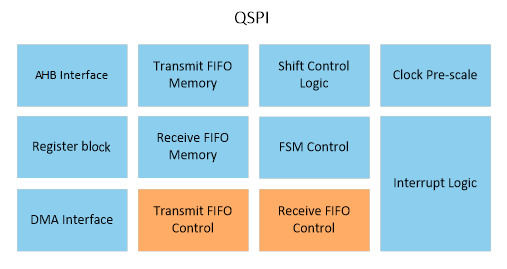

Block Diagram
- AHB interface and DMA controller interface
- Transmit and receive FIFO controllers and an FSM controller
- Register block
- Shift control and interrupt logic

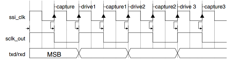

Clock Ratios
The maximum frequency of the bit-rate clock (sclk_out) is one-half the frequency of ssi_clk signal. This is to allow the shift control logic to capture data on one clock edge of sclk_out signal and propagate data on the opposite edge; this is illustrated in the following figure.
The frequency of sclk_out signal can be derived from the following equation.
Where, SCKDV (Baud Rate Register, BAUD[15:0]) is a programmable register holding any even value in the range of 0–65,534. If SCKDV = 0, sclk_out is disabled.
The sclk_out line only toggles when an active transfer is in progress. At all other time, it is held in inactive state, as define by the serial protocol under which it operates.

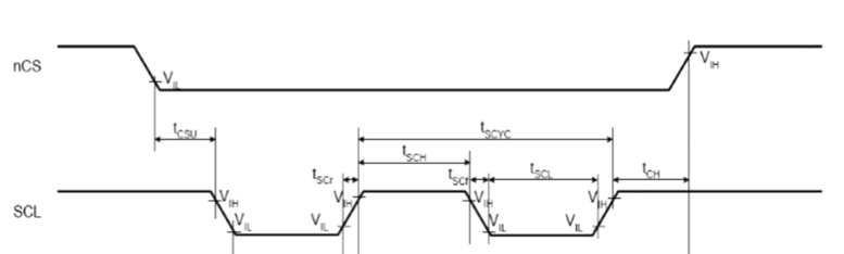

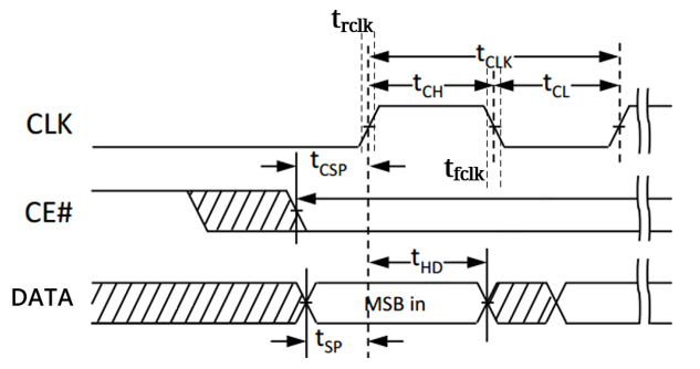

Related Delay Between CS and SCK
Tcsu (CS Setup Delay Time) is an important parameter to access QSPI device. If Tcsu is not enough, the access may fail.
Tch (CS Release Delay Time) is symmetric to Tcsu.
If necessary, users can set the two parameters wider to fit with devices’ requirement. The related registers are QSPI_CS_SETUP_DLY and QSPI_CS_RELEASE_DLY.

RX_SMP_DLY
- Name: Receive Sample Delay Register
- Description: This register controls the number of SCLK cycles that are delayed (from the default sample time) before the actual sample of the RXD input occurs. It is impossible to write to this register when the QSPI is enabled.
- Base Address: QSPI0: 0x40021000; QSPI1: 0x40022000; QSPI2: 0x40023000
- Offset: 0xF0
- Reset Value: 0x00000000
3:0 |
RX_SAMPLEDLY |
RW |
Receive sample delay |

Electrical Specifications
| Parameter[1] | Description | Min. | Typ. | Max. | Unit |
| fsck | Bit (baud) rate | 47.96 | 48 | MHz | |
| tclk | SCK clock period | 20.83 | 20.85 | ns | |
| trclk | SCK clock rise time (10% -90%), 9pF Loading | 1.45 | ns | ||
| tfclk | SCK clock fall time (90% - 10%), 9pF Loading | 1.40 | ns | ||
| tch | SCK clock high time | 8.97 | ns | ||
| tcl | SCK clock low time | 9.01 | ns | ||
| tcsp | CS Setup delay time to active clock edge | 10.4[2] | ns | ||
| 20.8[3] | ns | ||||
| tsp | Data Setup time to active clock edge | 10.4 | ns | ||
| 20.8 | ns | ||||
| thd | Data Hold time from active clock edge | 8.97 | ns |
[1]All values are measured under 48 MHz baud rate in Clock Mode 3.
[2]Default tcsp in XIP Mode and can be adjusted by either software or hardware.
[3]Default tcsp in Register Mode and can be adjusted by either software or hardware.
