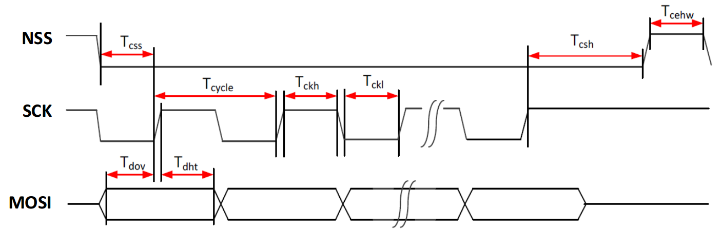

3W1L Display Interface
Figure 73 Serial data write timing on 3W1L display interface

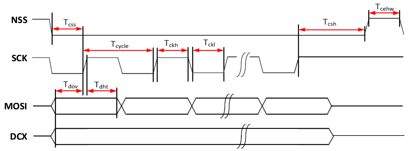

4W1L Display Interface
Figure 74 Serial data write timing on 4W1L display interface

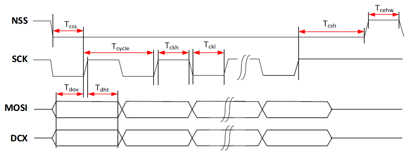

4W2L Display Interface
Figure 75 Serial data write timing on 4W2L display interface

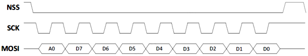

3W1L Display Interface [A0+8-bit]
3W1L interface in [A0+8-bit] mode, as illustrated in the figure below, allows putting a total of 9 bits per transaction on the MOSI wire, in which
  • First bit (“A0”) is the data-versus-command indicator bit.
  • Next 8 bits (D7 through D0) are data bits.
Figure 76 3W1L interface in [A0+8-bit] mode

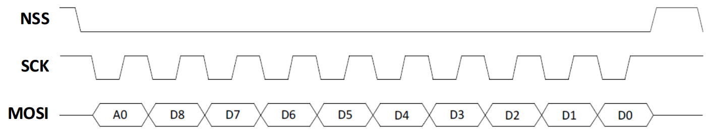

3W1L Display Interface [A0+9-bit]
3W1L interface in [A0+9-bit] mode, as illustrated in the figure below, allows putting a total of 10 bits per transaction on the MOSI wire, in which
  • Next 9 bits (D8 through D0) are data bits.
Figure 78 3W1L display interface [A0+9-bit] write

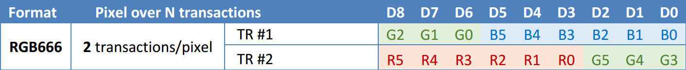

The following pixel format may be used in this 9-data-bit mode:
RGB666 pixel requires 18 bits hence it can be sent over 2 transactions.
Example pixel data mapping to D8:D0 bit periods is shown below.
Table 453 Example pixel data mapping to Dx bit periods for 3W1L [A0+9-bit] write

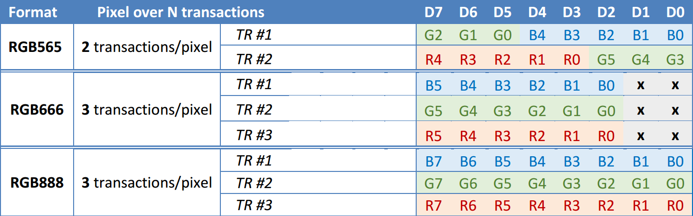

The following 3 pixel formats may be used in this 8-data-bit mode:
  • RGB565 pixel requires 16 bits hence it can be sent over 2 transactions.
  • RGB666 pixel requires 18 bits hence it can be sent over 3 transactions. Some bit periods are unused.
  • RGB888 pixel requires 24 bits hence it can be sent over 3 transactions.
Example pixel data mappings to D7:D0 bit periods are shown below.
Table 454 Example pixel data mappings to Dx bit periods for 4W1L [8-bit] write

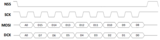

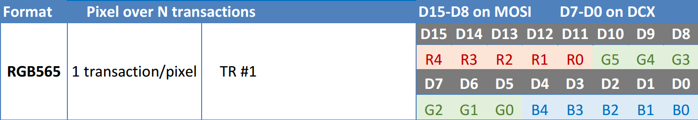

4W2L Display Interface [A0+8-bit]
4W2L interface in [A0+8-bit] mode, as illustrated in the figure below, allows putting a total of 18 bits per transaction on the MOSI and DCX wires, in which
  • First bit (“A0”) on both wires is the data-versus-command indicator bit. This bit is duplicated.
  • Next 8 bits (D7 through D0) on MOSI wire are data bits.
  • Next 8 bits (D15 through D8) on DCX wire are data bits.
Figure 82 4W2L interface in [A0+8-bit] mode
The following pixel format may be used in this 16-data-bit mode:
RGB565 pixel requires 16 bits hence it can be sent over 1 transaction.
Example pixel data mappings to D15:D0 bit periods are shown below..
Table 455 Example pixel data mappings to Dx bit periods for 4W2L [A0+8-bit] write

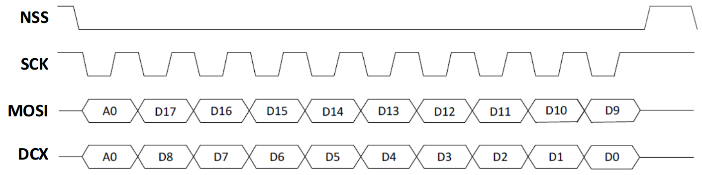

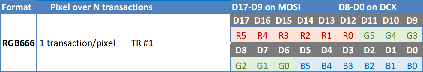

4W2L Display Interface [A0+9-bit]
4W2L interface in [A0+9-bit] mode, as illustrated in the figure below, allows putting a total of 20 bits per transaction on the MOSI and DCX wires, in which
  • Next 9 bits (D8 through D0) on MOSI wire are data bits.
  • Next 9 bits (D17 through D9) on DCX wire are data bits.
Figure 84 4W2L display interface [A0+9-bit]
The following pixel format may be used in this 18-data-bits mode:
RGB666 pixel requires 18 bits hence it can be sent over 1 transaction.
Example pixel data mappings to D17:D0 bit periods are shown below.
Table 456 Example pixel data mappings to Dx bit periods for 4W2L [A0+9-bit] write

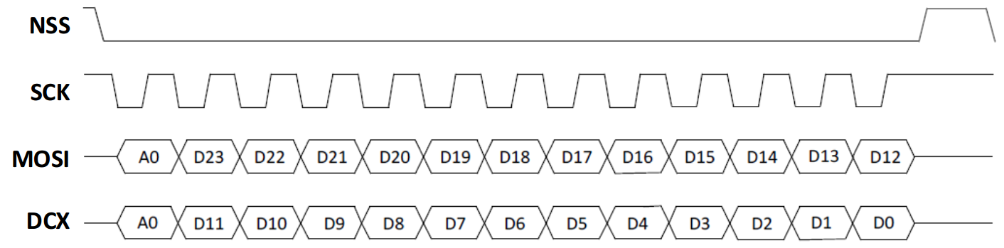

4W2L Display Interface [A0+12-bit]
4W2L interface in [A0+12-bit] mode, as illustrated in Figure 86, allows putting a total of 26 bits per transaction on the MOSI and DCX wires, in which
  • Next 12 bits (D23 through D12) on MOSI wire are data bits.
  • Next 12 bits (D11 through D0) on DCX wire are data bits.
Figure 86 4W2L display interface [A0+12-bit]

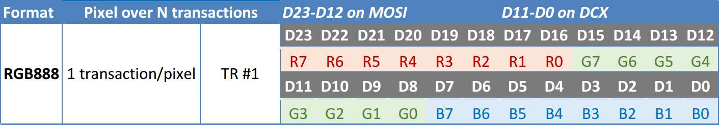

The following pixel format may be used in this 24-data-bit mode:
RGB888 pixel requires 24 bits hence it can be sent over 1 transaction.
Example pixel data mappings to D23:D0 bit periods are shown below.
Table 457 Example pixel data mappings to Dx bit periods for 4W2L [A0+12-bit] write
