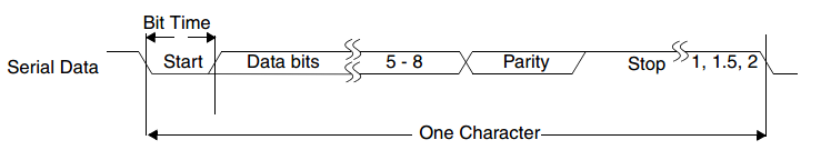

UART (RS232) Serial Protocol
The serial communication between the UART and a selected device is asynchronous, so additional start and stop bits are added to the serial data to indicate the beginning and end. Utilizing these bits allows two devices to be synchronized. This structure of serial data, accompanied by start and stop bits, is referred to as a character, as shown in Figure 43.
Figure 43 Timing diagram
An additional parity bit can be added to the serial character. This bit appears after the last data bit and before the stop bit(s) in the character structure in order to provide the UART with the ability to perform simple error checking on the received data.
The UART Line Control Register (LCR) is used to control the serial character characteristics. The individual bits of the data word are sent after the start bit, starting with the least-significant bit (LSB). These are followed by the optional parity bit, followed by the stop bit(s), which can be 1, 1.5, or 2.
All the bits in the transmission are transmitted for exactly the same time duration; the exception to this is the half-stop bit when 1.5 stop bits are used. This duration is referred to as a Bit Period or Bit Time; one Bit Time equals sixteen baud clocks.

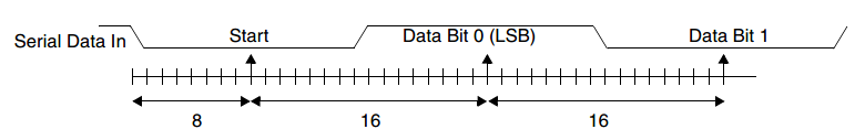

To ensure stability on the line, the receiver samples the serial input data at approximately the midpoint of the Bit Time once the start bit has been detected. The exact number of baud clocks that are transmitted by each bit is known, so calculating the midpoint for sampling is not difficult; the midpoint for sampling occurs every sixteen baud clocks after sampling is performed at the midpoint of the start bit.
Together with serial input debouncing, this sampling helps to avoid the detection of false start bits. Short glitches are filtered out by debouncing, and no transition is detected on the line. If a glitch is wide enough to avoid filtering by debouncing, a falling edge is detected. However, a start bit is detected only if the line is again sampled low after half a Bit Time has elapsed. Figure 44 shows the sampling points of the first two bits in a serial character.
Figure 44 Receiver serial data sample points

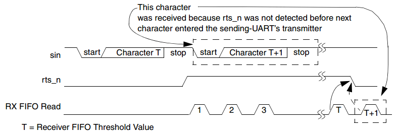

Auto Flow Control
The UART can be configured to have a 16750-compatible Auto Request to Send (RTS) and Auto Clear To Send (CTS) serial data flow control mode available; if FIFOs are not implemented, this mode cannot be selected. When Auto Flow Control is not selected, none of the corresponding logics is implemented, and the mode cannot be enabled, reducing overall gate counts. When Auto Flow Control mode is selected, it can be enabled with the Modem Control Register (MCR[5]). Figure 45 shows a block diagram of the Auto Flow Control functionality.
Figure 45 Auto Flow Control Block Diagram
  • Auto RTS becomes active when all the following conditions occur:
    • Auto Flow Control is selected during configuration
    • FIFOs are implemented
    • RTS (MCR[1] bit and MCR[5] bit are both set)
    • FIFOs are enabled (FCR[0]) bit is set)
    • SIR mode is disabled (MCR[6] bit is not set)
      When Auto RTS is enabled, the rts_n output is forced inactive (high) when the FIFO is almost full, where “almost full” refers to two available slots in the FIFO. When rts_n is connected to the cts_n input of another UART device, the other UART stops sending serial data until the receiver FIFO has available space; that is, until it is completely empty.
      The selectable receiver FIFO threshold values are:
      • 1
      • 1/4
      • 1/2
      • 2 less than full
    Since one additional character can be transmitted to the UART after rts_n has become inactive—due to data already having entered the transmitter block in the other UART— setting the threshold to “2 less than full” allows maximum use of the FIFO with a safety zone of one character.
    When the receiver FIFO becomes completely empty by reading the Receiver Buffer Register (RBR), the rts_n again becomes active (low), signaling the other UART to continue sending data. Figure 46 shows a timing diagram of the Auto RTS operation.
Figure 46 Auto RTS timing

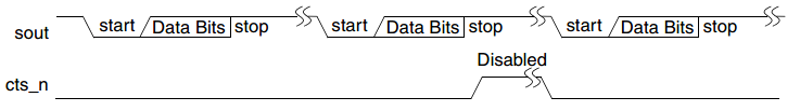

  • Auto CTS becomes active when all the following conditions occur:
    • AFCE (MCR[5] bit = 1)
    • FIFOs are enabled through FIFO Control Register FCR[0] bit
    • SIR mode is disabled (MCR[6] bit = 0)
      When Auto CTS is enabled (active), the UART transmitter is disabled whenever the cts_n input becomes inactive (high); this prevents overflowing the FIFO of the receiving UART. If the cts_n input is not inactivated before the middle of the last stop bit, another character is transmitted before the transmitter is disabled. While the transmitter is disabled, the transmitter FIFO can still be written to, and even overflowed. Therefore, when using this Auto CTS mode, the following happens:
    • UART status register can be read to check if transmit FIFO is full (USR[1] set to 0).
    • Current FIFO level can be read using TFL register.
    • Programmable THRE Interrupt mode must be enabled to access “FIFO full” status using Line Status Register (LSR).
When using the “FIFO full” status, software can poll this before each write to the Transmitter FIFO. When the cts_n input becomes active (low) again, transmission resumes. Figure 47 illustrates a timing diagram that shows the Auto CTS operation.
Figure 47 Auto CTS timing

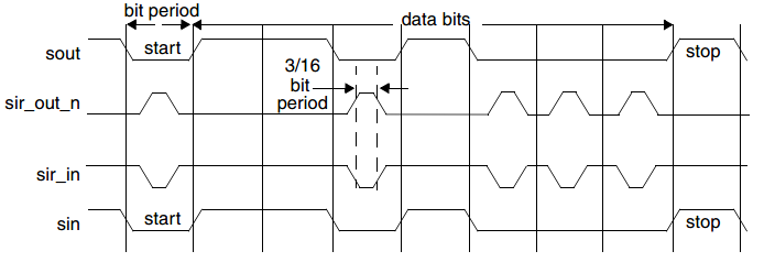

IrDA 1.0 SIR Protocol
The Infrared Data Association (IrDA) 1.0 Serial Infrared (SIR) mode supports bi-directional data communications with remote devices using infrared radiation as the transmission medium. IrDA 1.0 SIR mode specifies a maximum baud rate of 115.2 Kbaud.
The data format is similar to that of standard serial data. Each data character is sent serially in the following order:
  • Begins with a start bit
  • Followed by 8 data bits
  • Ends with at least one stop bit
Thus, the number of data bits that can be sent is fixed. No parity information can be supplied, and only one stop bit is used in this mode. Trying to adjust the number of data bits sent or enable parity with the Line Control Register (LCR) has no effect.
You can configure the UART for IrDA 1.0 SIR to perform the following:
  • Bit 6 of the Mode Control Register (MCR) enables or disables the IrDA 1.0 SIR mode.
  • Disabling IrDA SIR mode causes the logic not to be implemented; the mode cannot be activated, which reduces total gate counts.
  • When IrDA SIR mode is enabled and active, serial data is transmitted and received respectively on the sir_out_n and sir_in ports.
Transmission or non-transmission of a single infrared pulse indicates the following:
  • Transmitting a single infrared pulse indicates logic 0.
  • Non-transmission of a pulse indicates logic 1.
The width of each pulse is three sixteenths of a normal serial bit time. Thus, each new character begins with an infrared pulse for the start bit. However, received data is inverted from transmitted data due to infrared pulses energizing the photo transistor base of the IrDA receiver, which pulls its output low. This inverted transistor output is then fed to the UART sir_in port, which gives it the correct UART polarity.
Figure 50 IrDA SIR data format
When IrDA SIR mode is enabled, the UART operates in a manner similar to when the mode is disabled, with one exception: data transfers can only occur in half-duplex fashion when IrDA SIR mode is enabled. This is because the IrDA SIR physical layer specifies a minimum of 10 ms delay between transmission and reception; this 10 ms delay must be generated by software.

Break Control Bit.
This is used to cause a break condition to be transmitted to the receiving device. If set to one the serial output is forced to the spacing (logic 0) state. When not in Loopback Mode, as determined by MODEM_CTRL[4], the sout line is forced low until the Break bit is cleared. When in Loopback Mode, the break condition is internally looped back to the receiver and the sir_out_n line is forced low.
Value:
  • 0x0 (DISABLED): Serial output is released for data transmission
  • 0x1 (ENABLED): Serial output is forced to spacing state
5
STICK_PARITY
RW
0x0
Stick Parity.
This bit is used to force parity value. When PARITY_EN, EVEN_PARITY_SEL and STICK_PARITY are set to 1, the parity bit is transmitted and checked as logic 0. If PARITY_EN and Stick Parity are set to 1 and EVEN_PARITY_SEL is a logic 0, then parity bit is transmitted and checked as a logic 1. If this bit is set to 0, Stick Parity is disabled.
Value:
  • 0x0 (DISABLED): STICK_PARITY disabled
  • 0x1 (ENABLED): STICK_PARITY enabled
4
EVEN_PARITY_SEL
RW
0x0
Even Parity Select.
This is used to select between even and odd parity, when parity is enabled (PEN set to one). If this bit is set to one, an even number of logic '1's is transmitted or checked. If set to zero, an odd number of logic '1's is transmitted or checked.
Value:
  • 0x0 (ODD_PARITY): an odd parity is transmitted or checked
  • 0x1 (EVEN_PARITY): an even parity is transmitted or checked
3
PARITY_EN
RW
0x0
Parity Enable.
This bit is used to enable and disable parity generation and detection in transmitted and received serial character respectively.
Value:
  • 0x0 (DISABLED): disable parity
  • 0x1 (ENABLED): enable parity
2
STOP_BITS
RW
0x0
Number of Stop bits.
This is used to select the number of Stop bits per character that the peripheral will transmit and receive. If set to zero, one stop bit is transmitted in the serial data. If this bit is set to one and the Data bits are set to 5 (LCR[1:0] set to zero), one and a half Stop bits are transmitted. Otherwise, two Stop bits are transmitted. Note that regardless of the number of stop bits selected, the receiver will only check the first Stop bit.
Note:
The Stop bit duration implemented by UART may appear longer due to idle time inserted between characters for some configurations and baud clock divisor values in the transmit direction.
Value:
  • 0x0 (STOP_1BIT): 1 stop bit
  • 0x1 (STOP_1_5BIT_OR_2BIT): 1.5 stop bits when DATA_LEN_SEL (LINE_CTRL[1:0]) is zero, else 2 stop bit
1:0
DATA_LEN_SEL
RW
0x0
Data Length Select (or CLS as used in legacy).
When DATA_LEN_SEL_E in LCR_EXT is set to 0, this register is used to select the number of data bits per character that the peripheral will transmit and receive.
Value:
  • 0x0 (CHAR_5BITS): 5 data bits per character
  • 0x1 (CHAR_6BITS): 6 data bits per character
  • 0x2 (CHAR_7BITS): 7 data bits per character
  • 0x3 (CHAR_8BITS): 8 data bits per character

6 SIRE RW 0x0
SIR Mode Enable
Writeable only when SIR_MODE == Enabled, always readable. This is used to enable/disable the IrDA SIR Mode features.
Value:
  • 0x0 (DISABLED): IrDA SIR Mode disabled.
  • 0x1 (ENABLED): IrDA SIR Mode enabled.

1
REQ_TO_SEND
RW
0x0
Request to Send.
This is used to directly control the Request to Send (rts_n) output. The Request To Send (rts_n) output is used to inform the modem or data set that the UART is ready to exchange data.
Value:
  • 0x0 (INACTIVE): Request to Send rts_n de-asserted (logic 1)
  • 0x1 (ACTIVE): Request to Send rts_n asserted (logic 0)

4
CLR_SEND
R
0x0
Clear to Send.
This is used to indicate the current state of the modem control line cts_n. That is, this bit is the complement cts_n. When the Clear to Send input (cts_n) is asserted, it is an indication that the modem or data set is ready to exchange data with the UART. In Loopback Mode (MODEM_CTRL[4] set to one), CLR_SEND is the same as MODEM_CTRL[1] (REQ_TO_SEND).
Value:
  • 0x0 (DEASSERTED): cts_n input is de-asserted (logic 1)
  • 0x1 (ASSERTED): cts_n input is asserted (logic 0)
3:1
RSVD
R
Reserved bits
0
DELTA_CLR_SEND
R
0x0
Delta Clear to Send.
This is used to indicate that the modem control line cts_n has changed since the last time the MODEM_STAT was read. Reading the MODEM_STAT clears the DELTA_CLR_SEND bit. In Loopback Mode (MODEM_CTRL[4] set to one), DELTA_CLR_SEND reflects changes on MODEM_CTRL[1] (REQ_TO_SEND).
Note:
If the DELTA_CLR_SEND bit is not set and the cts_n signal is asserted (low) and a reset occurs (software or otherwise), then the DELTA_CLR_SEND bit will get set when the reset is removed if the cts_n signal remains asserted.
Value:
  • 0x0 (NO_CHANGE): no change on cts_n since last read of MODEM_STAT
  • 0x1 (CHANGE): change on cts_n since last read of MODEM_STAT
