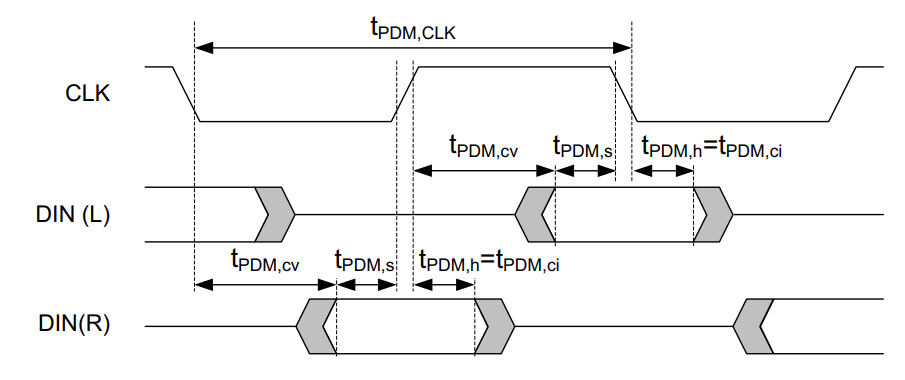

Electrical Specifications
Table 515 Electrical specifications
Symbol Description Min. Typ. Max. Unit
fPdm,clk,64
PDM clock speed
1
M
tPDM,JITTER
Jitter in PDM clock output
20
ns
tPDM,DATA
Decimation filter delay
6.125
ms
tPDM,cv
Allowed clock edge to data valid
56
ns
tPDM,ci
Allowed (other) clock edge to data invalid
49
ns
tPDM,s
Data setup time at fPDM,CLK = 1 MHz
65
ns
tPDM,h
Data hold time at fPDM,CLK = 1 MHz
0
ns
GPDM,default
Default (reset) absolute gain of the PDM module
0
dB
The PDM timing diagram is as below:
Figure 97 PDM timing diagram
