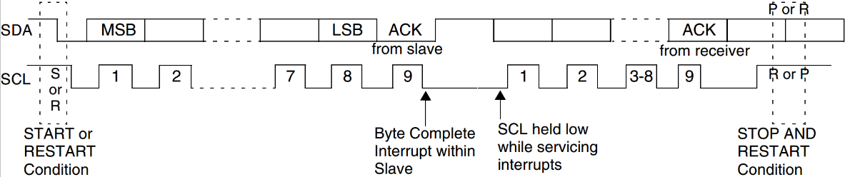

I2C Operation
The I2C is a synchronous serial interface. The SDA line is a bidirectional signal and changes only when the SCL line is low, except for STOP, START, and RESTART conditions. The output drivers are open-drain or open-collector to perform wired-AND functions on the bus. The maximum number of devices on the bus is limited by only the maximum capacitance specification of 400 pF. Data is transmitted in byte packages.
The master is responsible for generating the clock and controlling the transfer of data. The slave is responsible for either transmitting or receiving data to/from the master. The acknowledgement of data is sent by the device that is receiving data, which can be either a master or a slave. The I2C protocol also allows multiple masters to reside on the I2C bus and uses an arbitration procedure to determine the bus ownership.
When a master wants to communicate with a slave, the master transmits a START/RESTART condition that is then followed by the slave address and a control bit (R/W) to determine if the master wants to transmit data to or receive data from the slave. The slave then sends an acknowledge (ACK) pulse after the address.
If the master (master-transmitter) is writing to the slave (slave-receiver), the receiver gets one byte of data. This transaction continues until the master terminates the transmission with a STOP condition. If the master is reading from a slave (master-receiver), the slave transmits (slave-transmitter) a byte of data to the master, and the master then acknowledges the transaction with the ACK pulse. This transaction continues until the master terminates the transmission by not acknowledging (NACK) the transaction after the last byte is received, and then the master issues a STOP condition or addresses another slave after issuing a RESTART condition. This behavior is illustrated in the figure below.
图 68 Data transfer on the I2C bus

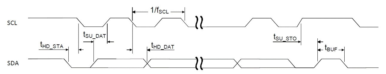

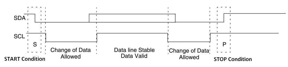

START and STOP Conditions
When I2C operates as a Master, putting data into the transmit FIFO causes the I2C block to generate a START condition on the I2C bus. Writing 1 to DATA_CMD[9] causes the I2C block to generate a STOP condition on the I2C bus; a STOP condition is not issued if this bit is not set, even if the transmit FIFO is empty.
When the bus is idle, both the SCL and SDA signals are pulled high through external pull-up resistors on the bus. When a master wants to start a transmission on the bus, the master issues a START condition. This is defined as a high-to-low transition of the SDA signal while SCL is high. When a master wants to terminate the transmission, the master issues a STOP condition. This is defined as a low-to-high transition of the SDA line while SCL is high. The following figure shows the timing of the START and STOP conditions. When data is being transmitted on the bus, the SDA line must be stable when the SCL is high.
图 69 Timing of START and STOP conditions

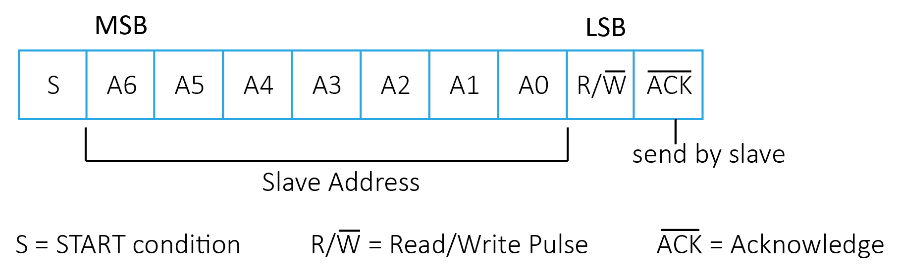

7-bit Address Format
sing the 7-bit address format, the first seven bits (bits 7:1) of the first byte set the slave address and the least significant bit (bit 0) (LSB) is the R/W bit as shown in the figure below. When bit 0 (R/W) is set to 0, the master writes to the slave. When bit 0 (R/W) is set to 1, the master reads from the slave.
图 70 7-bit address format

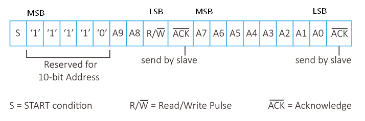

10-bit Address Format
Using the 10-bit address format, two bytes are transferred to set the 10-bit address. The transfer of the first byte contains the following bit definition. The first five bits (bits 7:3) notify the slave that this is a 10-bit transfer followed by the next two bits (bits 2:1), which set the slave address (bits 9:8), and the LSB bit (bit 0) is the R/W bit. The second byte transferred sets bits 7:0 of the slave address. The figure below shows the 10-bit address format.
图 71 10-bit address format

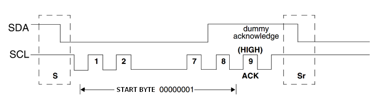

START BYTE Transfer
The START BYTE transfer protocol is set up for systems that do not have an on-board dedicated I2C hardware module. When the I2C block is addressed as a slave, it always samples the I2C bus at the highest speed supported so that it never requires a START BYTE transfer. However, when the I2C block is a master, it supports the generation of START BYTE transfers that a slave device might require at the beginning of every transfer.
This protocol consists of seven zeros being transmitted followed by a one, as illustrated in the figure below. This allows the processor that is polling the bus to under-sample the address phase until 0 is detected. Once the microcontroller detects a 0, it switches from the under sampling rate to the correct rate of the master.
图 74 START BYTE transfer
The START BYTE procedure is as follows:
  1. Master generates a START condition.
  2. Master transmits the START byte (0000 0001).
  3. Master transmits the ACK clock pulse. (Present only to conform with the byte handling format used on the bus)
  4. No slave sets the ACK signal to 0.
  5. Master generates a RESTART condition.
A hardware receiver does not respond to the START BYTE because it is a reserved address and resets after the RESTART condition is generated.
