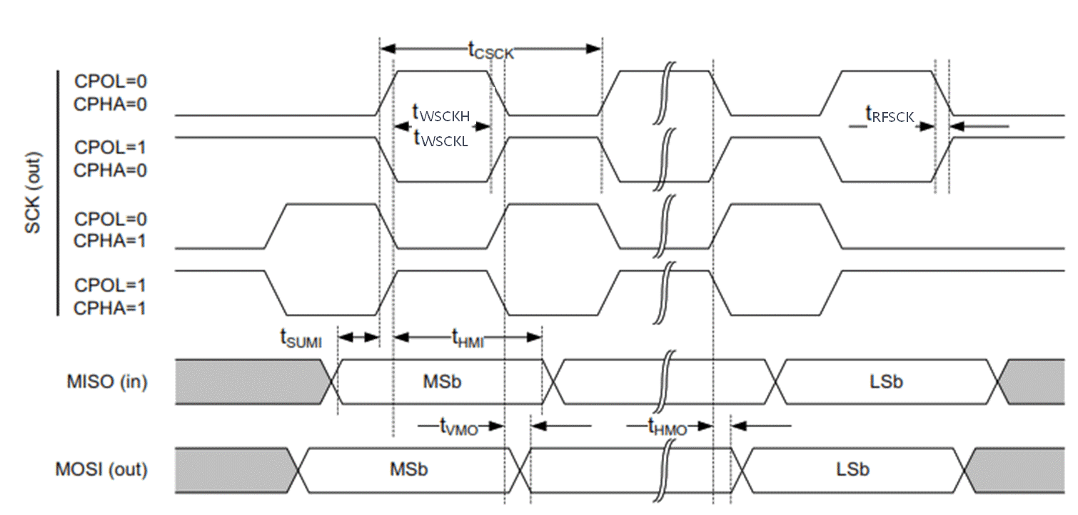

- Supports SPI four modes for different clock edge and phase configurations.

With the SPI, the clock polarity (SERIAL_CLK_POL) configuration parameter determines whether the inactive state of the serial clock is high or low. To transmit data, both SPI peripherals must have identical serial clock phase (SERIAL_CLK_PHASE, controlled by CTRL0[6]) and clock polarity (SERIAL_CLK_POL, controlled by CTRL0[7]) values. The data frame can be 4 bits to 32 bits.
When the configuration parameter SERIAL_CLK_PHASE = 0, data transmission begins on the falling edge of the slave select signal. The first data bit is captured by the master and slave peripherals on the first edge of the serial clock; therefore, valid data must be present on the txd and rxd lines prior to the first serial clock edge.

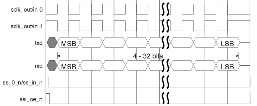

The following figure shows a timing diagram for a single SPI data transfer with SERIAL_CLK_PHASE = 0 (CTRL0[6] = 0). The serial clock is shown for configuration parameters SERIAL_CLK_POL = 0 (CTRL0[7] = 0) and SERIAL_CLK_POL = 1 (CTRL0[7] = 1).
The following signals are illustrated in the timing diagrams in this section:
- sclk_out – serial clock from SPI block master (master configuration only)
- sclk_in – serial clock from SPI block slave (slave configuration only)
- txd – transmit data line for the SPI block master/slave
- rxd – receive data line for the SPI block master/slave
- ss_0_n – slave select signal from SPI block master (master configuration only)
- ss_in_n – slave select input to the SPI block slave
- ss_oe_n – output enable for the SPI block master/slave

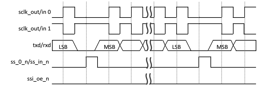

Two different modes of continuous data transfers are supported when SERIAL_CLK_PHASE = 0; the selection of the desired operation mode is done by configuring bit24 (S_ST_EN) of the CTRL0 register:
When CTRL0[24] is programmed to 1, spi block toggles the slave select signal between frames, and the serial clock is held to its default value while the slave select signal is active; this operating mode is illustrated in the figure below.
Figure 62 Serial format continuous transfers (SERIAL_CLK_PHASE = 0) when CTRL0[24] = 1 -
