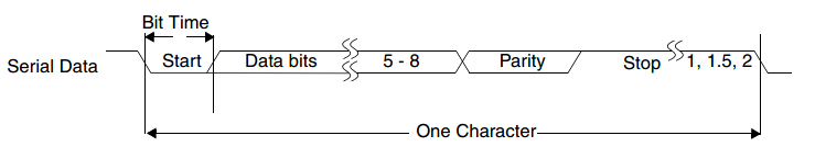

UART (RS232) Serial Protocol
The serial communication between the UART and a selected device is asynchronous, so additional start and stop bits are added to the serial data to indicate the beginning and end. Utilizing these bits allows two devices to be synchronized. This structure of serial data, accompanied by start and stop bits, is referred to as a character, as shown below.
Figure 52 Timing diagram -
An additional parity bit can be added to the serial character. This bit appears after the last data bit and before the stop bit(s) in the character structure in order to provide the UART with the ability to perform simple error checking on the received data.
The UART Line Control Register (LCR) is used to control the serial character characteristics. The individual bits of the data word are sent after the start bit, starting with the least significant bit (LSB). These are followed by the optional parity bit, followed by the stop bit(s), which can be 1, 1.5, or 2.
All the bits in the transmission are transmitted for exactly the same time duration; the exception to this is the half-stop bit when 1.5 stop bits are used. This duration is referred to as a Bit Period or Bit Time; one Bit Time equals sixteen baud clocks.

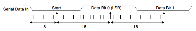

To ensure stability on the line, the receiver samples the serial input data at approximately the midpoint of the Bit Time once the start bit has been detected. The exact number of baud clocks that are transmitted by each bit is known, so calculating the midpoint for sampling is not difficult; the midpoint for sampling occurs every sixteen baud clocks after sampling is performed at the midpoint of the start bit.
Together with serial input debouncing, this sampling helps to avoid the detection of false start bits. Short glitches are filtered out by debouncing, and no transition is detected on the line. If a glitch is wide enough to avoid filtering by debouncing, a falling edge is detected. However, a start bit is detected only if the line is again sampled low after half a Bit Time has elapsed. The following figure shows the sampling points of the first two bits in a serial character.
Figure 53 Receiver serial data sample points -

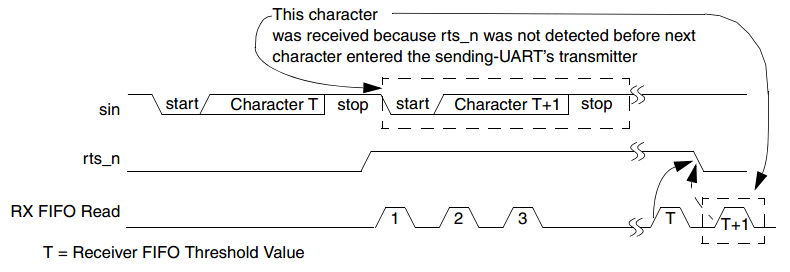

When Auto RTS is enabled, the rts_n output is forced inactive (high) when the FIFO is almost full, where “almost full” refers to two available slots in the FIFO. When rts_n is connected to the cts_n input of another UART device, the other UART stops sending serial data until the receiver FIFO has available space; that is, until it is completely empty.
The selectable receiver FIFO threshold values are:
- 1
- 1/4
- 1/2
- 2 less than full
Because one additional character can be transmitted to the UART after rts_n has become inactive—due to data already having entered the transmitter block in the other UART— setting the threshold to “2 less than full” allows maximum use of the FIFO with a safety zone of one character.
When the receiver FIFO becomes completely empty by reading the Receiver Buffer Register (RBR), the rts_n again becomes active (low), signaling the other UART to continue sending data. The following figure shows a timing diagram of the Auto RTS operation.
Figure 55 Auto RTS timing -

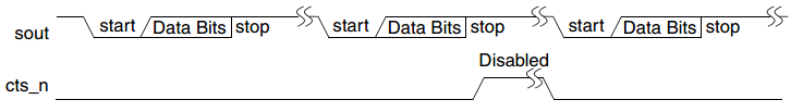

Auto CTS becomes active when all the following conditions occur:
Auto Flow Control is selected during configuration
FIFOs are implemented
AFCE (MCR[5] bit = 1)
FIFOs are enabled through FIFO Control Register FCR[0] bit.
When Auto CTS is enabled (active), the UART transmitter is disabled whenever the cts_n input becomes inactive (high). This prevents overflowing the FIFO of the receiving UART. If the cts_n input is not inactivated before the middle of the last stop bit, another character is transmitted before the transmitter is disabled. While the transmitter is disabled, the transmitter FIFO can still be written to, and even overflowed. Therefore, when using this Auto CTS mode, the following happens:

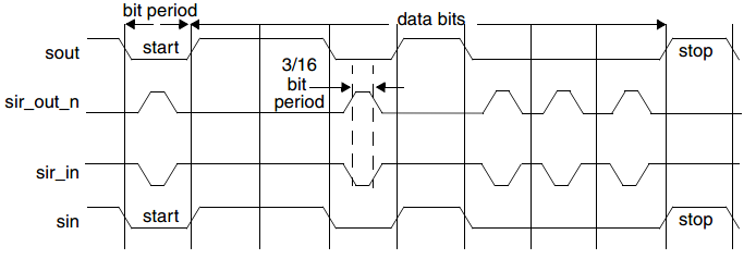

When IrDA SIR mode is enabled and active, serial data is transmitted and received on the sir_out_n and sir_in ports, respectively.
Transmission or non-transmission of a single infrared pulse indicates the following:
Transmitting a single infrared pulse indicates logic 0.
Non-transmission of a pulse indicates logic 1.
The width of each pulse is 3/16ths of a normal serial bit time. Thus, each new character begins with an infrared pulse for the start bit. However, received data is inverted from transmitted data due to infrared pulses energizing the photo transistor base of the IrDA receiver, which pulls its output low. This inverted transistor output is then fed to the UART sir_in port, which gives it the correct UART polarity.
When IrDA SIR mode is enabled, the UART operates in a manner similar to when the mode is disabled, with one exception: data transfers can only occur in half-duplex fashion when IrDA SIR mode is enabled. This is because the IrDA SIR physical layer specifies a minimum of 10 ms delay between transmission and reception; this 10 ms delay must be generated by software.

LCR
Name: Line Control Register
Description: Line Control Register
Base Address: 0x4000C500 + x*0x100
Offset: 0x0C
Reset Value: 0x00000000
| 31:8 |
RSVD |
R |
Reserved bits |
| 7 |
DLAB |
RW |
0x0 |
Divisor Latch Access Bit. This bit is used to enable reading and writing of the Divisor Latch Register (DLL and DLH) to set the baud rate of the UART. This bit must be cleared after initial baud rate setup in order to access other registers. Value:
| 6 |
BC |
RW |
0x0 |
Break Control Bit. This is used to cause a break condition to be transmitted to the receiving device. If set to one the serial output is forced to the spacing (logic 0) state. When not in Loopback Mode, as determined by MCR[4], the sout line is forced low until the Break bit is cleared. When in Loopback Mode, the break condition is internally looped back to the receiver and the sir_out_n line is forced low. Value:
| 5 |
STICK_PARITY |
RW |
0x0 |
Stick Parity. This bit is used to force parity value. When PARITY, EVEN_PARITY_SEL and STICK_PARITY are set to 1, the parity bit is transmitted and checked as logic 0. If PARITY and Stick Parity are set to 1 and EVEN_PARITY_SEL is a logic 0, then parity bit is transmitted and checked as a logic 1. If this bit is set to 0, Stick Parity is disabled. Value:
| 4 |
EVEN_PARITY_SEL |
RW |
0x0 |
Even Parity Select. This is used to select between even and odd parity, when parity is enabled (PEN set to one). If this bit is set to one, an even number of logic '1's is transmitted or checked. If set to zero, an odd number of logic '1's is transmitted or checked. Value:
| 3 |
PARITY |
RW |
0x0 |
Parity Enable. This bit is used to enable and disable parity generation and detection in transmitted and received serial character respectively. Value:
| 2 |
STOP |
RW |
0x0 |
Number of Stop bits. This is used to select the number of Stop bits per character that the peripheral will transmit and receive. If set to 0, one stop bit is transmitted in the serial data. If this bit is set to 1 and the Data bits are set to 5 (LCR[1:0] set to 0), one and a half Stop bits are transmitted. Otherwise, two Stop bits are transmitted. Note that regardless of the number of stop bits selected, the receiver will only check the first Stop bit. Note: The Stop bit duration implemented by UART may appear longer due to idle time inserted between characters for some configurations and baud clock divisor values in the transmit direction. Value:
| 1:0 |
DLS |
RW |
0x0 |
Data Length Select (or CLS as used in legacy). This field is used to select the number of data bits per character that the peripheral will transmit and receive. Value:
MCR
Name: Modem Control Register
Description: Modem Control Register
Offset: 0x10
31:6 |
RSVD |
R |
Reserved bits |
5 |
AFCE |
RW |
0x0 |
Auto Flow Control Enable When FIFOs are enabled and the Auto Flow Control Enable (AFCE) bit is set, Auto Flow Control features are enabled as described in “Auto Flow Control”. Value:
4 |
LOOPBACK |
RW |
0x0 |
Loopback Bit. This is used to put the UART into a diagnostic mode for test purposes. Value:
3:2 |
RSVD |
R |
Reserved bits |
1 |
RTS |
RW |
0x0 |
Request to Send. This is used to directly control the Request to Send (rts_n) output. The Request To Send (rts_n) output is used to inform the modem or data set that the UART is ready to exchange data. Value:
0 |
RSVD |
R |
Reserved bits |

MSR
Name: Modem Status Register
Description: Whenever bit 0 is set to logic 1 to indicate a change on the modem control inputs, a modem status interrupt will be generated if enabled via the INT_EN regardless of when the change occurred. The bits (bit 0) can be set after a reset, even though their respective modem signals are inactive, because the synchronized version of the modem signals have a reset value of 0 and change to value 1 after reset. To prevent unwanted interrupts due to this change, a read of the MSR register can be performed after reset.
Offset: 0x18
31:5 |
RSVD |
R |
Reserved bits |
4 |
CTS |
R |
0x0 |
Clear to Send. This is used to indicate the current state of the modem control line cts_n. That is, this bit is the complement cts_n. When the Clear to Send input (cts_n) is asserted, it is an indication that the modem or data set is ready to exchange data with the UART. In Loopback Mode (MCR[4] set to one), CLR_SEND is the same as MCR[1] (RTS). Value:
3:1 |
RSVD |
R |
Reserved bits |
0 |
DCTS |
R |
0x0 |
Delta Clear to Send. This is used to indicate that the modem control line cts_n has changed since the last time the MSR was read. Reading the MSR clears the DCTS bit. In Loopback Mode (MCR[4] set to one), DCTS reflects changes on MCR[1] (RTS). Note: If the DCTS bit is not set and the cts_n signal is asserted (low) and a reset occurs (software or otherwise), then the DCTS bit will get set when the reset is removed if the cts_n signal remains asserted. Value:

DLF
Name: Divisor Latch Fraction Register
Description: Divisor Latch Fraction Register
Offset: 0xC0
31:4 |
RSVD |
R |
Reserved bits |
3:0 |
DLF |
RW |
0x0 |
Fractional part of divisor. The fractional value is added to integer value set by DLH and DLL. Fractional value is determined by (Divisor Fraction value, DLF.DLF)/(2^DLF_SIZE), where DLF_SIZE = 4. |
Electrical Specifications
| Baud Rate | Divider | DLH Reg | DLL Reg | DLF Reg | Actual Baud Rate | Error (%) |
| 1200 | 3333.33 | 13 | 5 | 5 | 1200 | 0 |
| 2400 | 1666.67 | 6 | 130 | 11 | 2399.97 | 0 |
| 4800 | 833.33 | 3 | 65 | 5 | 4800.12 | 0 |
| 9600 | 416.67 | 1 | 160 | 11 | 9599.52 | 0.05 |
| 14400 | 277.78 | 1 | 21 | 12 | 14401.44 | 0.01 |
| 19200 | 208.33 | 0 | 208 | 6 | 19201.92 | 0.01 |
| 28800 | 138.89 | 0 | 138 | 14 | 28802.88 | 0.01 |
| 38400 | 104.17 | 0 | 104 | 3 | 38392.32 | 0.02 |
| 57600 | 69.44 | 0 | 69 | 7 | 57605.76 | 0.01 |
| 115200 | 34.72 | 0 | 34 | 12 | 115107.91 | 0.08 |
| 230400 | 17.36 | 0 | 17 | 6 | 230215.83 | 0.08 |
| 460800 | 8.68 | 0 | 8 | 11 | 460431.65 | 0.08 |
| 921600 | 4.34 | 0 | 4 | 5 | 927536.23 | 0.64 |
| 1000000 | 4 | 0 | 4 | 0 | 1000000 | 0 |
| 2000000 | 2 | 0 | 2 | 0 | 2000000 | 0 |
