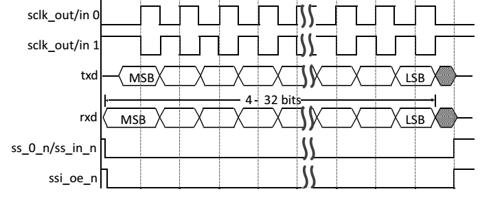

With the SPI, the clock polarity (SERIAL_CLK_POL) configuration parameter determines whether the inactive state of the serial clock is high or low. To transmit data, both SPI peripherals must have identical serial clock phase (SERIAL_CLK_PHASE, controlled by CTRL0[6]) and clock polarity (SERIAL_CLK_POL, controlled by CTRL0[7]) values. The data frame can be 4 bits to 32 bits.
When the configuration parameter SERIAL_CLK_PHASE = 0, data transmission begins on the falling edge of the slave select signal. The first data bit is captured by the master and slave peripherals on the first edge of the serial clock; therefore, valid data must be present on the txd and rxd lines prior to the first serial clock edge.
The following figure shows a timing diagram for a single SPI data transfer with SERIAL_CLK_PHASE = 0 (CTRL0[6] = 0). The serial clock is shown for configuration parameters SERIAL_CLK_POL = 0 (CTRL0[7] = 0) and SERIAL_CLK_POL = 1 (CTRL0[7] = 1).
Figure 62 SPI serial format (SERIAL_CLK_PHASE = 0)
The following signals are illustrated in the timing diagrams in this section:
  • sclk_out – serial clock from SPI block master (master configuration only)
  • sclk_in – serial clock from SPI block slave (slave configuration only)
  • txd – transmit data line for the SPI block master/slave
  • rxd – receive data line for the SPI block master/slave
  • ss_0_n – slave select signal from SPI block master (master configuration only)
  • ss_in_n – slave select input to the SPI block slave
  • ss_oe_n – output enable for the SPI block master/slave

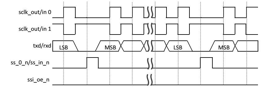

Two different modes of continuous data transfers are supported when SERIAL_CLK_PHASE = 0; the selection of the desired operation mode is done by configuring bit24 (S_ST_EN) of the CTRL0 register:
  • When CTRL0[24] is programmed to 1, spi block toggles the slave select signal between frames, and the serial clock is held to its default value while the slave select signal is active; this operating mode is illustrated in the figure below.
    Figure 63 Serial format continuous transfers (SERIAL_CLK_PHASE = 0) when CTRL0[24] = 1

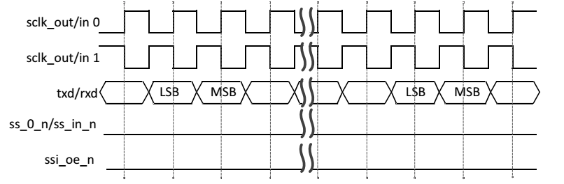

  • When CTRL0[24] is programmed to 0, the slave selects signal stays low and the serial clock runs continuously for the duration of the transfer; this operating mode is illustrated below.
    Figure 64 Serial format continuous transfers (SERIAL_CLK_PHASE = 0) when CTRL0[24] = 0

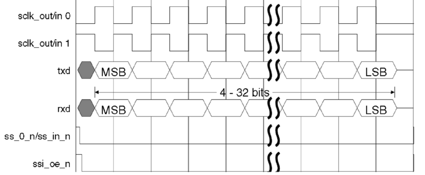

  • When the configuration parameter SERIAL_CLK_PHASE = 1 (CTRL0[6] = 1), both master and slave peripherals begin transmitting data on the first serial clock edge after the slave select line is activated. The first data bit is captured on the second (trailing) serial clock edge. Data is propagated by the master and slave peripherals on the leading edge of the serial clock. During continuous data frame transfers, the slave select line may be held active-low until the last bit of the last frame has been captured.
    Figure 65 SPI serial format (SERIAL_CLK_PHASE = 1)

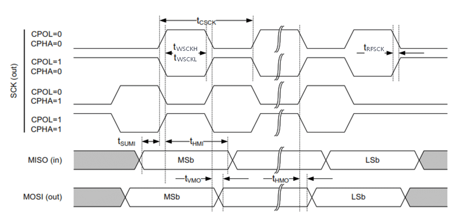

Electrical Specifications
SPIM Electrical Specifications
Table 429 SPIM electrical specifications
Parameter Description Min. Typ. Max. Unit
fSCK Clock frequency 32 MHz
tCSCK SCK clock period 31.25 ns
tRSCK SCK rise time, 15 pF loading tRF,15pF [1] ns
tFSCK SCK fall time, 15 pF loading tRF,15pF [1] ns
tWSCKH SCK clock high time 7.625[2] ns
tWSCKL SCK clock low time 7.625[2] ns
tSUMI Data input setup time (MISO to SCK edge) 5 ns
tHMI Data input hold time (SCK edge to MISO change) 5 ns
tVMO Data output valid time (SCK edge to MOSI valid) 0 ns
tHMO MOSI hold time after CLK edge 20 ns
[1] The SCK rise time and the SCK fall time are obtained with SPIM timing shown in Figure 66.
[2] The SCK clock high time and SCK clock low time are calculated by (tCSCK/2)–tRSCK and (tCSCK/2)–tFSCK, respectively.
The SPIM timing diagram is as below:
Figure 66 SPIM timing diagram

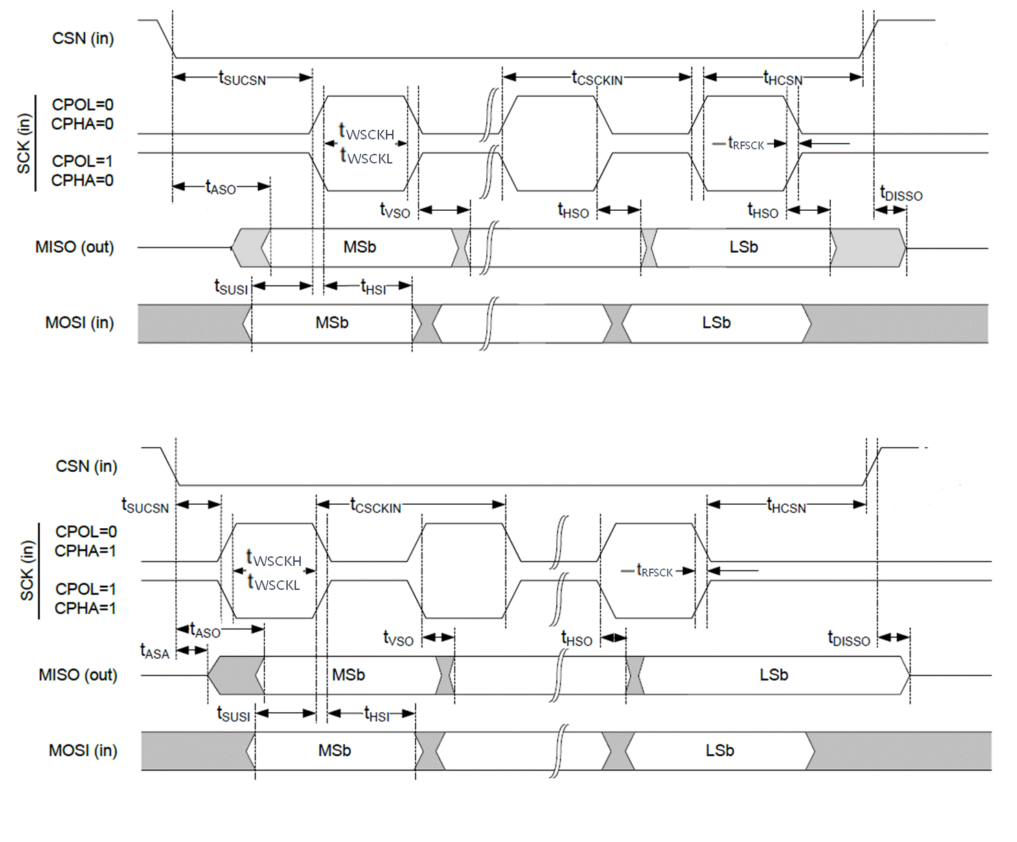

SPIS Electrical Specifications
Table 430 SPIS electrical specifications
Symbol Description Min. Typ. Max. Unit
fSCK Clock frequency 10.67 MHz
tCSCK SCK input clock period 93.7 ns
tRFSCK SCK input clock rise/fall time 22 ns
tWSCKH SCK input clock high time 22 ns
tWSCKL SCK input clock low time 22 ns
tSUCSN CSN input setup time 62.5 ns
tHCSN CSN input hold time 31.25 ns
tASO Data output access time (from CSN to MISO valid) 62.5 ns
tDISSO Data output disable time (from CSN to MISO disabled) 62.5 ns
tVSO Data output valid time (from SCK to MISO valid) 20 ns
tHSO Data output hold time (from SCK to MISO change) 8 ns
tSUSI Data input setup time (from MOSI to SCK) 18 ns
tHSI Data input hold time (from SCK to MOSI change) 0 ns
Note:
If SPIS performs RX and TX concurrently, the maximum bit rate will decrease to 5.33 Mbps.
The SPIS timing diagram is shown below:
Figure 67 SPIS timing diagram
