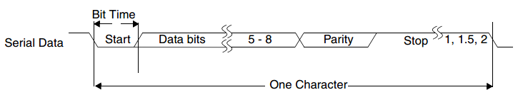

  • The serial communication between the UART and a selected device is asynchronous, so additional start and stop bits are added to the serial data to indicate the beginning and end. Utilizing these bits allows two devices to be synchronized. This structure of serial data, accompanied by start and stop bits, is referred to as a character, as shown below.
    Figure 53 Timing diagram
  • An additional parity bit can be added to the serial character. This bit appears after the last data bit and before the stop bit(s) in the character structure in order to provide the UART with the ability to perform simple error checking on the received data.
  • The UART Line Control Register (LCR) is used to control the serial character characteristics. The individual bits of the data word are sent after the start bit, starting with the least significant bit (LSB). These are followed by the optional parity bit, followed by the stop bit(s), which can be 1, 1.5, or 2.
  • All the bits in the transmission are transmitted for exactly the same time duration; the exception to this is the half-stop bit when 1.5 stop bits are used. This duration is referred to as a Bit Period or Bit Time; one Bit Time equals sixteen baud clocks.
  • To ensure stability on the line, the receiver samples the serial input data at approximately the midpoint of the Bit Time once the start bit has been detected. The exact number of baud clocks that are transmitted by each bit is known, so calculating the midpoint for sampling is not difficult; the midpoint for sampling occurs every sixteen baud clocks after sampling is performed at the midpoint of the start bit.
  • Together with serial input debouncing, this sampling helps to avoid the detection of false start bits. Short glitches are filtered out by debouncing, and no transition is detected on the line. If a glitch is wide enough to avoid filtering by debouncing, a falling edge is detected. However, a start bit is detected only if the line is again sampled low after half a Bit Time has elapsed. The following figure shows the sampling points of the first two bits in a serial character.

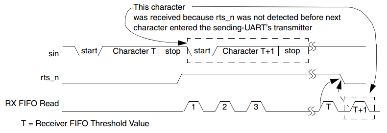

  • Auto RTS becomes active when all the following conditions occur:
    • Auto Flow Control is selected during configuration
    • FIFOs are implemented
    • RTS (Both MCR[1] bit and MCR[5] bit are set)
    • FIFOs are enabled (FCR[0]) bit is set)
    When Auto RTS is enabled, the rts_n output is forced inactive (high) when the FIFO is almost full, where “almost full” refers to two available slots in the FIFO. When rts_n is connected to the cts_n input of another UART device, the other UART stops sending serial data until the receiver FIFO has available space; that is, until it is completely empty.
    The selectable receiver FIFO threshold values are:
    • 1
    • 1/4
    • 1/2
    • 2 less than full
    Because one additional character can be transmitted to the UART after rts_n has become inactive—due to data already having entered the transmitter block in the other UART— setting the threshold to “2 less than full” allows maximum use of the FIFO with a safety zone of one character.
    When the receiver FIFO becomes completely empty by reading the Receiver Buffer Register (RBR), the rts_n again becomes active (low), signaling the other UART to continue sending data. The following figure shows a timing diagram of the Auto RTS operation.
    Figure 56 Auto RTS timing

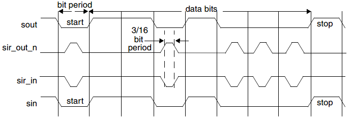

IrDA 1.0 SIR Protocol
The Infrared Data Association (IrDA) 1.0 Serial Infrared (SIR) mode supports bi-directional data communications with remote devices using infrared radiation as the transmission medium. IrDA 1.0 SIR mode specifies a maximum baud rate of 115.2 Kbaud.
The data format is similar to the standard serial data format. Each data character is sent serially in the following order:
  • Begins with a start bit
  • Followed by 8 data bits
  • Ends with at least one stop bit
Thus, the number of data bits that can be sent is fixed. No parity information can be supplied, and only one stop bit is used in this mode. Trying to adjust the number of data bits sent or enable parity with the Line Control Register (LCR) has no effect.
Configuration of the UART for IrDA 1.0 SIR does the following:
  • Bit 6 of the Mode Control Register (MCR) enables or disables the IrDA 1.0 SIR mode.
  • Disabling IrDA SIR mode causes the logic not to be implemented; the mode cannot be activated, which reduces total gate counts.
  • When IrDA SIR mode is enabled and active, serial data is transmitted and received on the sir_out_n and sir_in ports, respectively.
Transmission or non-transmission of a single infrared pulse indicates the following:
  • Transmitting a single infrared pulse indicates logic 0.
  • Non-transmission of a pulse indicates logic 1.
The width of each pulse is 3/16ths of a normal serial bit time. Thus, each new character begins with an infrared pulse for the start bit. However, received data is inverted from transmitted data due to infrared pulses energizing the photo transistor base of the IrDA receiver, which pulls its output low. This inverted transistor output is then fed to the UART sir_in port, which gives it the correct UART polarity.
Figure 60 IrDA SIR data format
When IrDA SIR mode is enabled, the UART operates in a manner similar to when the mode is disabled, with one exception: data transfers can only occur in half-duplex fashion when IrDA SIR mode is enabled. This is because the IrDA SIR physical layer specifies a minimum of 10 ms delay between transmission and reception; this 10 ms delay must be generated by software.
