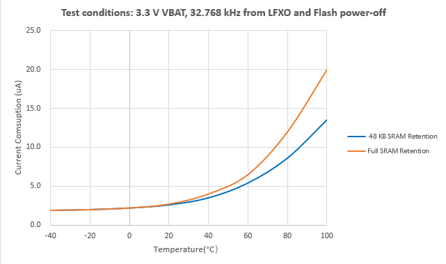

Sleep Mode
Typical conditions: VBAT = 3.3 V, system clock = 32.768 kHz@LFXO, Flash power-off.
The figure below shows the typical current curves of the device in sleep mode with different SRAM retention modes.

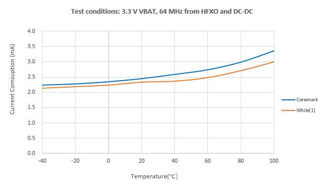

Active Mode
Typical conditions: VBAT = 3.3 V, system clock = 64 MHz@HFXO, regulator = DC-DC.
The figure below shows the typical current curves of the device in active mode (Coremark vs. While(1)) with various temperatures.

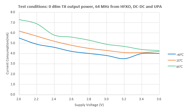

Radio Transmitting @ 0dBm Output Power for GR5331/GR5330
Typical conditions: system clock = 64 MHz @HFXO, regulator = DC-DC, RF power amplifier = UPA.
The figure below shows the typical current curves of the GR5331/GR5330 at 0 dBm TX output power, with various supply voltages and temperatures.

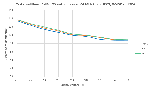

Radio Transmitting @ 6dBm Output Power for GR5331/GR5330
Typical conditions: system clock = 64 MHz @HFXO, regulator = DC-DC, RF power amplifier = SPA.
The figure below shows the typical current curves of the GR5331/GR5330 at 6 dBm TX output power, with various supply voltages and temperatures.

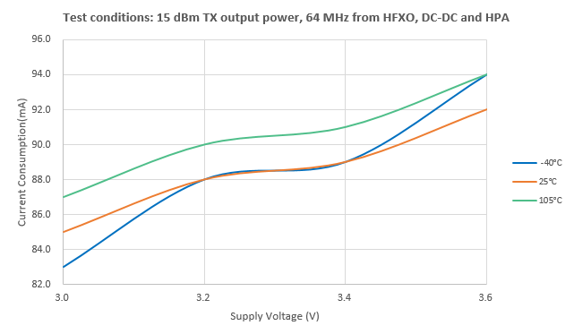

Radio Transmitting @ 15dBm Output Power for GR5332
Typical conditions: System clock = 64 MHz @HFXO, regulator = SYS_LDO, RF power amplifier = HPA.
The figure below shows the typical current curves of the GR5332 at 15 dBm TX output power, considering various supply voltages and temperatures.
