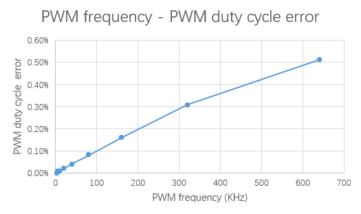

For example, when the clock frequency is 64 MHz and the duty cycle is in the range of 1 to 100, the maximum PWM frequency can only be set to 640 KHz in the PWM_ALIGNED_EDGE mode, and can only be set to 320 KHz in the PWM_ALIGNED_CENTER mode.
In a system clock with frequency 64 MHz, duty cycle errors at different PWM frequencies are as follows:
| PWM Frequency | PWM Duty Cycle Error |
| 640 KHz | 0.51% |
| 320 KHz | 0.31% |
| 160 KHz | 0.16% |
| 80 KHz | 0.08% |
| 40 KHz | 0.04% |
| 20 KHz | 0.02% |
| 10 KHz | 0.01% |
| 5 KHz | 0.01% |
| 2.5 KHz | <0.01% |
| 320 KHz | 0.51% |
| 160 KHz | 0.16% |
| 80 KHz | 0.08% |
| 40 KHz | 0.04% |
| 20 KHz | 0.02% |
| 10 KHz | 0.01% |
| 5 KHz | 0.01% |
| 2.5 KHz | <0.01% |
