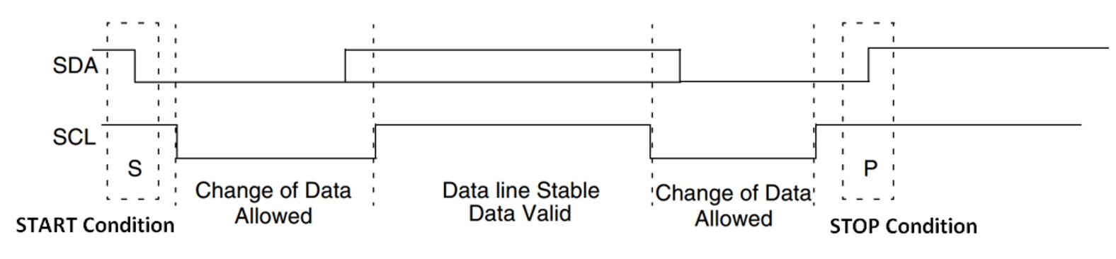

When the bus is idle, both the SCL and SDA signals are pulled high through external pull-up resistors on the bus. When a master wants to start a transmission on the bus, the master issues a START condition. This is defined as a high-to-low transition of the SDA signal while SCL is high. When a master wants to terminate the transmission, the master issues a STOP condition. This is defined as a low-to-high transition of the SDA line while SCL is high. 图 23 shows the timing of the START and STOP conditions. When data is being transmitted on the bus, the SDA line must be stable when the SCL is high.

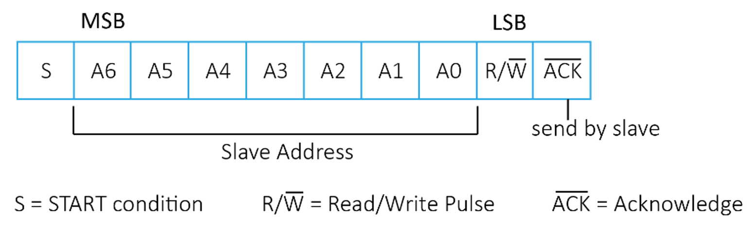

Using the 7-bit address format, the first seven bits (bits 7:1) of the first byte set the slave address and the least significant bit (bit 0) (LSB) is the R/W bit as shown in 图 24. When bit 0 (R/W) is set to 0, the master writes to the slave. When bit 0 (R/W) is set to 1, the master reads from the slave.

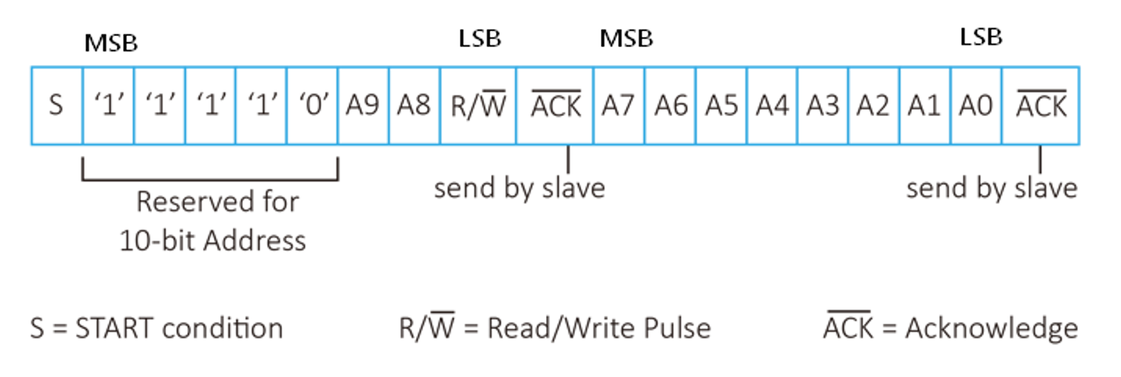

Using the 10-bit address format, two bytes are transferred to set the 10-bit address. The transfer of the first byte contains the following bit definition. The first five bits (bits 7:3) notify the slave that this is a 10-bit transfer followed by the next two bits (bits 2:1), which set the slave address (bits 9:8), and the LSB bit (bit 0) is the R/W bit. The second byte transferred sets bits 7:0 of the slave address. 图 25 shows the 10-bit address format.

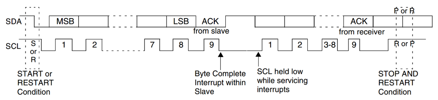

All data is transmitted in byte format, with no limit on the number of bytes transferred per data transfer. After the master sends the address and R/W bit or the master transmits a byte of data to the slave, the slave-receiver must respond with the ACK signal. When a slave-receiver does not respond with an ACK pulse, the master aborts the transfer by issuing a STOP condition. The slave must leave the SDA line high so that the master can abort the transfer.
If the master-transmitter is transmitting data as shown in 图 26, the slave-receiver responds to the master-transmitter with an ACK pulse after every data byte is received.

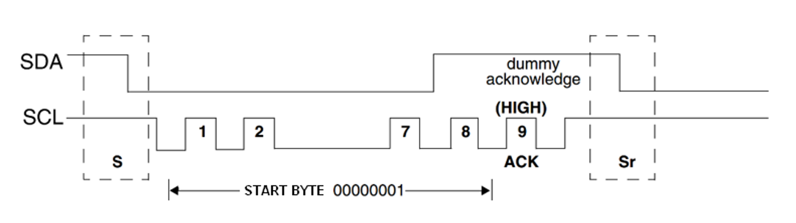

The START BYTE transfer protocol is set up for systems that do not have an on-board dedicated I2C hardware module. When the I2C block is addressed as a slave, it always samples the I2C bus at the highest speed supported so that it never requires a START BYTE transfer. However, when the I2C block is a master, it supports the generation of START BYTE transfers that a slave device might require at the beginning of every transfer.
This protocol consists of seven zeros being transmitted followed by a one, as illustrated in 图 28. This allows the processor that is polling the bus to under-sample the address phase until 0 is detected. Once the microcontroller detects a 0, it switches from the under sampling rate to the correct rate of the master.
图 28 START BYTE Transfer
The START BYTE procedure is as follows:
  1. Master generates a START condition.
  2. Master transmits the START byte (0000 0001).
  3. Master transmits the ACK clock pulse. (Present only to conform with the byte handling format used on the bus)
  4. No slave sets the ACK signal to 0.
  5. Master generates a RESTART condition.
A hardware receiver does not respond to the START BYTE because it is a reserved address and resets after the RESTART condition is generated.
