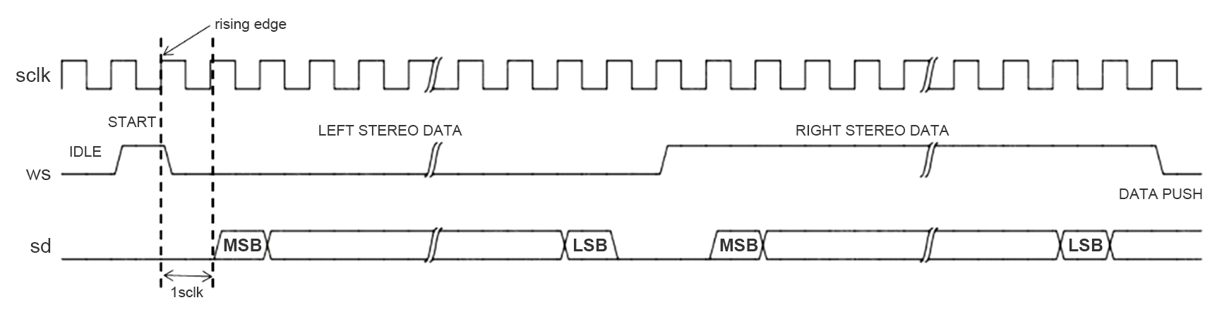

The I2S module of GR551x used the I2S Philips standard. For instance, when WS is low, the word being transferred is left stereo data; when WS is high, the word being transferred is right stereo data. For standard I2S formats, the MSB of a word is sent one SCLK cycle after a WS change. Serial data sent by the transmitter can be synchronized with either the negative edge or positive edge of the SCLK signal. However, the receiver must latch the serial data on the rising edge of SCLK.
图 44 illustrates an example I2S transfer in which I2S Controller is a slave. The IDLE state of WS line is 0. Whenever the WS line makes a transition to 1, it means that after the next transition (0->1), the data starts being received. Therefore, the I2S Controller slave treats the transfer as a START condition. When the stereo data is completely latched (signaled by Word Select Line going 0 again, also treated as start of new data frame), the data is pushed into the internal FIFO.
