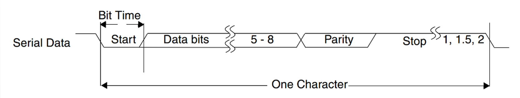

Because the serial communication between the UART and a selected device is asynchronous, additional bits (Start and Stop) are added to the serial data to indicate the beginning and end. Utilizing these bits allows two devices to be synchronized. This structure of serial data — accompanied by Start and Stop bits—is referred to as a character, as shown in 图 31.

An additional Parity bit can be added to the serial character. This bit appears after the last Data bit and before the Stop bit(s) in the character structure in order to provide the UART with the ability to perform simple error checking on the received data.
The UART Line Control Register (LINE_CTRL register) is used to control the serial character characteristics. The individual bits of the data word are sent after the Start bit, starting with the least significant bit (LSB). These are followed by the optional parity bit, followed by the Stop bit(s), which can be 1, 1.5, or 2.
All the bits in the transmission are transmitted for exactly the same time duration except when 1.5 stop bits are used. This duration is referred to as a Bit Period or Bit Time; one Bit Time equals sixteen baud clocks.

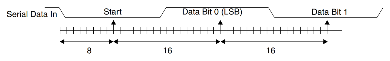

To ensure stability on the line, the receiver samples the serial input data at approximately the midpoint of the Bit Time when the start bit has been detected. The exact number of baud clocks is known for which each bit was transmitted, so calculating the midpoint for sampling is not difficult; every sixteen baud clocks sample from the Start bit to the midpoint.
Together with serial input debouncing, this sampling helps to avoid the detection of false start bits. Short glitches are filtered out by debouncing, and no transition is detected on the line. If a glitch is wide enough to avoid filtering by debouncing, a falling edge is detected. However, a start bit is detected only if the line is again sampled low after half a bit time has elapsed.
图 32 shows the sampling points of the first two bits in a serial character.
图 32 Receiver Serial Data Sample Points

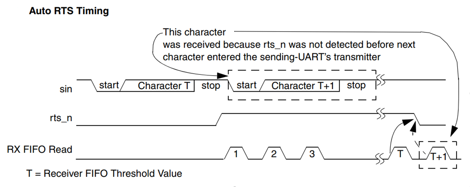

When Auto RTS is enabled, the rts_n output is forced inactive (high) when the receiver FIFO level reaches the threshold. When rts_n is connected to the cts_n input of another UART device, the other UART stops sending serial data until the receiver FIFO has available space; that is, until it is completely empty. The selectable threshold values of Receiver FIFO are:
  • 1
  • 1/4
  • 1/2
  • 2 less than full
Since one additional character can be transmitted to the UART, after rts_n has become inactive due to data already having entered the transmitter block in the other UART—setting the threshold to "2 less than full" allows maximum use of the FIFO with a safety zone of one character. Once the receiver FIFO becomes completely empty by reading the Receiver Buffer Register, rts_n again becomes active (low), signaling the other UART to continue sending data.
图 36 Auto RTS timing

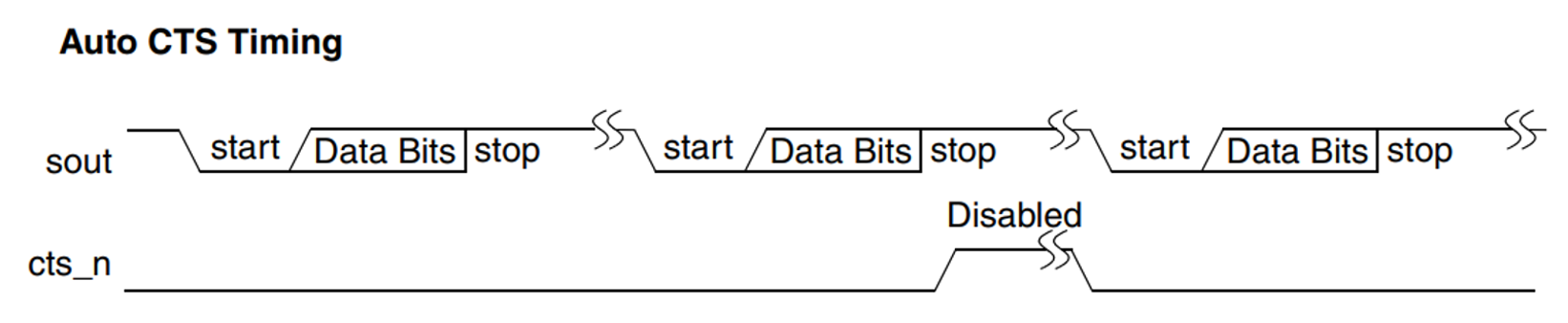

When Auto CTS is enabled (active), the UART transmitter becomes disabled whenever the cts_n input becomes inactive (high); this prevents overflowing the FIFO of the receiving UART. If the cts_n input is not inactivated before the middle of the last stop bit, another character is transmitted before the transmitter is disabled. While the transmitter is disabled, the transmitter FIFO can still be written to, and even overflowed.
图 37 Auto CTS timing
