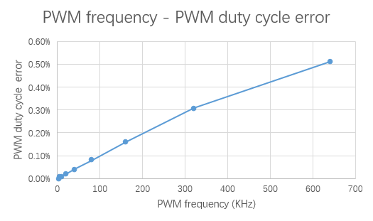

表 287 Duty cycle error in PWM_ALIGNED_CENTER mode
PWM Frequency PWM Duty Cycle Error
320 KHz 0.51%
160 KHz 0.16%
80 KHz 0.08%
40 KHz 0.04%
20 KHz 0.02%
10 KHz 0.01%
5 KHz 0.01%
2.5 KHz <0.01%
图 63 PWM frequency - PWM duty cycle error curve
