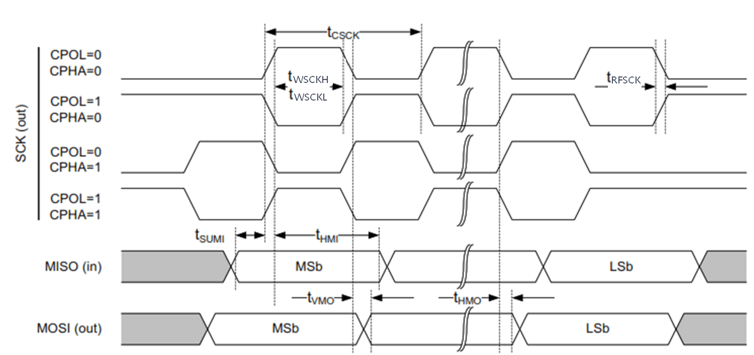

Electrical Specifications
SPIM Electrical Specifications
表 171 SPIM Electrical Specifications
Parameter Description Min. Typ. Max. Unit
fSCK
Clock frequency
32
MHz
tCSCK
SCK clock period
31.25
ns
tRSCK
SCK rise time, 15 pF loading
tRF,15pF[1]
ns
tFSCK
SCK fall time, 15 pF loading
tRF,15pF[1]
ns
tWSCKH
SCK clock high time
7.625 [2]
ns
tWSCKL
SCK clock low time
7.625 [2]
ns
tSUMI
Data input setup time (MISO to SCK edge)
5
ns
tHMI
Data input hold time (SCK edge to MISO change)
5
ns
tVMO
Data output valid time (SCK edge to MOSI valid)
0
ns
tHMO
MOSI hold time after CLK edge
20
ns
[1] The SCK rise time and the SCK fall time are from 图 39.
[2] The SCK clock high time and the SCK clock low time are calculated by (tCSCK/2)–tRSCK and (tCSCK/2)–tFSCK, respectively.
The SPIM Timing Diagram is as below:
图 39 SPIM Timing Diagram

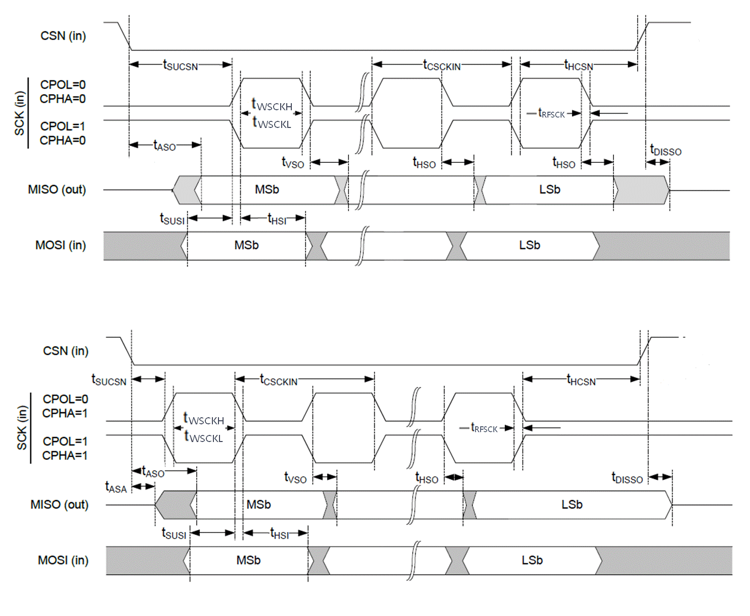

SPIS Electrical Specifications
表 172 SPIS Electrical Specifications
Symbol Description Min. Typ. Max. Unit
fSCK
Clock frequency
10.67
MHz
tCSCK
SCK input clock period
93.7
ns
tRFSCK
SCK input clock rise/fall time
22
ns
tWSCKH
SCK input clock high time
22
ns
tWSCKL
SCK input clock low time
22
ns
tSUCSN
CSN input setup time
62.5
ns
tHCSN
CSN input hold time
31.25
ns
tASO
Data output access time (from CSN to MISO valid)
62.5
ns
tDISSO
Data output disable time (from CSN to MISO disabled)
62.5
ns
tVSO
Data output valid time (from SCK to MISO valid)
20
ns
tHSO
Data output hold time (from SCK to MISO change)
8
ns
tSUSI
Data input setup time (from MOSI to SCK)
18
ns
tHSI
Data input hold time (from SCK to MOSI change)
0
ns
Note:
If SPIS performs RX and TX concurrently, Max bit rate will decrease to 5.33 Mbps.
SPIS Timing Diagram is shown below:
图 40 SPIS Timing Diagram
